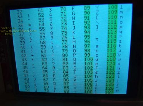

Do you think that we can get an extension of the PEEK function to locate the character set table (to replace some characters using POKE e.g. "°" the degree sign)?
  Quote  CFunctions now have the ability to call some functions within MMBasic.
That's seems to open a new world!
Michael
EDIT:
The chr$(127) looks a bit strange! Or I need glasses. Edited by twofingers 2015-05-28

  Quote  Do you think that we get an extention of the PEEK function to locate the character set table (to replace some characters using POKE e.g. "°" the degree)?
Michael
The font table is in flash so can't be changed with POKE. You can use the Bitmap command to output any arbitrary 8x8 bitmap.
Try
bitmap x,y,&H0000000c12120c00 Edited by matherp 2015-05-28

Maybe I can patch the hex file. For your Graphic Library I replaced chr$(127) with the degree symbol. BITMAP can serve as a workaround, I think. But the degree symbol in the character set would be more convenient. I'm lazy! [)]
Michael
EDIT:
  Quote  Try
or
BitMap 10,20,&HFFFFFFF3EDEDF3FF (black on white)
BitMap 10,30,&H0000000006090600
BitMap 10,60,&HFFFFFFFFF9F6F9FF (black on white)
Jims(Tassyjim) font editor (called "fontoMite") can be a tool for creating bitmap patterns. Edited by twofingers 2015-05-28

  twofingers said  The chr$(127) looks a bit strange! Or I need glasses.
No, your eyes are OK. That is a bug, the character is not in the printable character set and therefore should have printed as a blank (I will fix it in the next release).
By the way, in this version unprintable characters will print as a space. I thought that this was more helpful than the previous version which did nothing.
