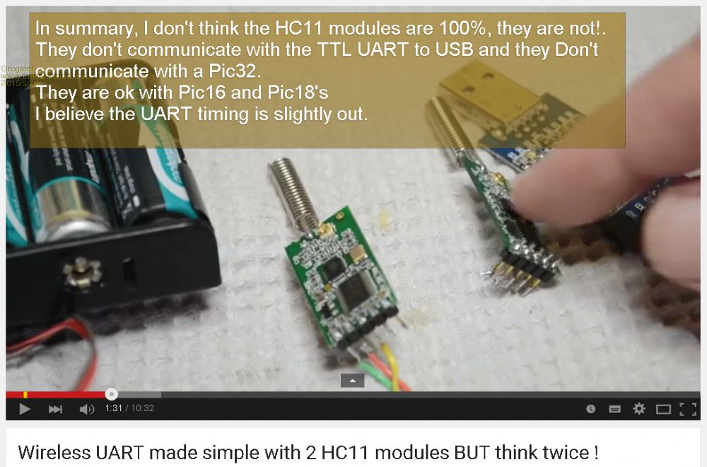

Banda sent me some modules to play with, that he could not get working - neither could I. They seem like a bit of a 50/50 bet, from what I can find.
Have a look at this video.
While in the audio of the video, it seems he has them working, but the text-box update I have shown below seems to say it all, really.....
My conclusion: AVOID. Has anyone else here used these modules with the Micromite with success?
I have tried connecting these modules to a VT100, and they flatly refuse to talk in any way whatsoever, either in normal mode, or in command mode where you should be able to get an "OK" back for AT commands. Out of interest, I might hook up a PICAXE and see if they will talk to them.
EDIT: Here is another video which seems to confirm this issue.
