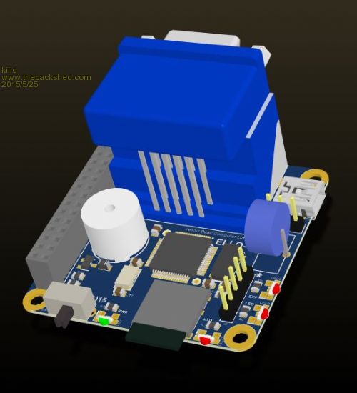

With the current trend of mass development, here is something from me as well.
I decided to take on the challenge and make a working PIC32MZ system with a BASIC (obviously will need to rewrite the interpreter). So the SBC which I was working on gradually evolved into a new smaller PIC32MZ-based system.

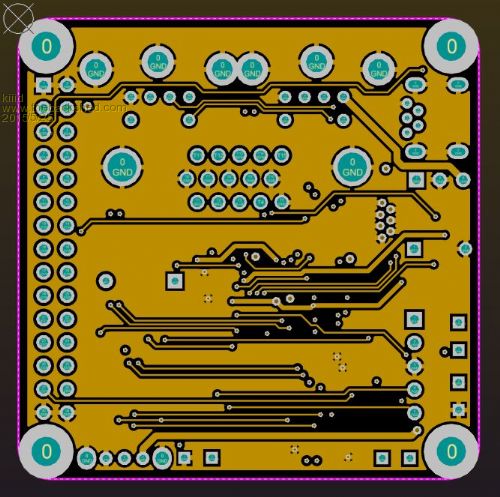

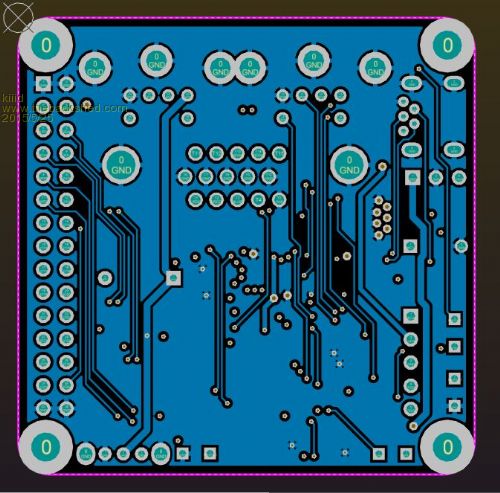

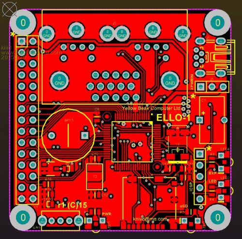

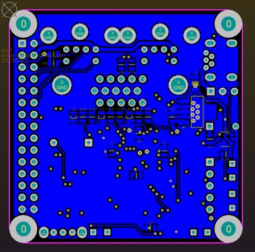

This is a true single chip 50x50mm solution where except for the 64-pinner 32MZ there is a bunch of caps and r's and a few connectors.
I have gone (again) for 16-colour graphics since this looks to me the reasonable amount of required memory vs what's available in the micro. However the design allows 1- or 8-colour configurations as well. Also switching from full size SD to micro SD in this board. Underneath the VGA connector there are two PS/2 ones - one is for a keyboard, plus two extra configurable A/I/O, the other one is CMOS UART and I2C (also configurable I/O). The board is powered from the miniUSB port, but can be configured to take external power as well.
The PCBs are currently in the factory. It is a 4-layer PCB. I have ordered 10 bare pieces but will not be using all of them, and if anyone else wants a piece for own play, please be welcome and let me know. This is a very early stage project and I still haven't got the software for it, but eventually I will make the whole thing open source for education.

Wow Kon..!
Nice layout you got there..! I like the VGA-KBD conbo connector you have designed in... Where did you find it..? Is there any more info on the design..?
Looks sweet..!

The combo is Norcomp 999-H15-PS2L571.
I will release more details about the design as soon as I verify the entire hardware after assembling the first board.

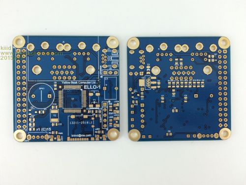

Update:
The PCBs are finally ready. Time comes to assemble one which with 0805 being the smallest components on board shouldn't be much of a challenge. More updates soon...
