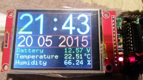

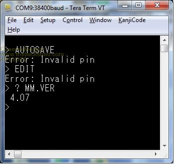

Geoff, as it is with betas, I got stuck after configuring the LCD and touch.
OPTION LCDPANEL ILI9341,L,4,5,6
OPTION TOUCH 7,2
Have I used an incorrect pin?
GM
PS. GUI TEST DISPLAY still works (and I am impressed with that )Edited by Graeme Meager 2015-05-21

My apologies Graeme (and everyone else who hit this issue).
Beta 3 should fix this issue. Download it from here:
http://geoffg.net/Downloads/Micromite/Micromite_4.7_Beta3.zip
I have a suite of test programs that I run to verify a release but unfortunately they do not cater for various combinations of pin numbers - that requires me to manually plug wires in and run tests. As a result it is hard to cover all combinations.

I think the invalid pin is returned if the OPTION LCDPANEL is already initialised.
If you issue OPTION LCDPANEL DISABLE you can then issue a new OPTION LCDPANEL ILI...
This seems to be case for both beta2 and beta3.
Is this a good thing! If the OPTION LCDPANEL is like an AUTOSAVE and has a finite number of cycles before it wears out the memory, then this would prevent you accidentally putting it in a loop and running it many times, maybe a better error.

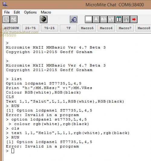

I have just installed 4.7 beta 3 ... the instruction " option lcdpanel " seems failing:
If I remove the instruction " option lcdpanel " it works!!

I forgot to indicate that I have a LCD ST7735 1.8" 128x160 from sainsmart...

@CFLY you cant use option lcdpanel within a program.
GM
BobD
Joined: 07/12/2011
Posts: 935
Posted: 01:57am 20 May 2015
Christophe
as the message is saying, it is invalid in a program. You can only issue that option from the command line. Not in a program.
Bob

OK thank you, thus, if I want to have an application which runs only, without connection with the pc, after transfer of the program, in command line :
" autorun option one " and " option lcdpanel " ... ok, good ...

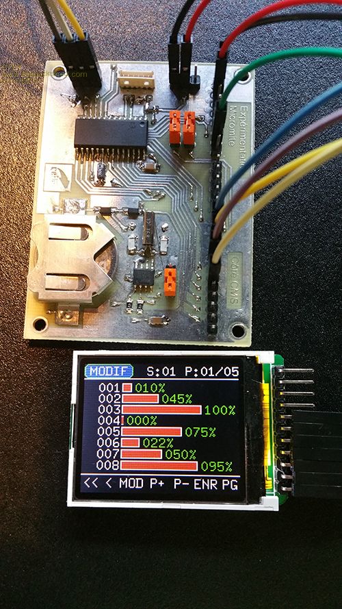

An example of realization with the MkII 28b and MMbasic ver 4.7b3. And 1.8 TFT LCD ( ST7735)...
CLS, ROX, tested RBOX and TEXT ... it works well...
