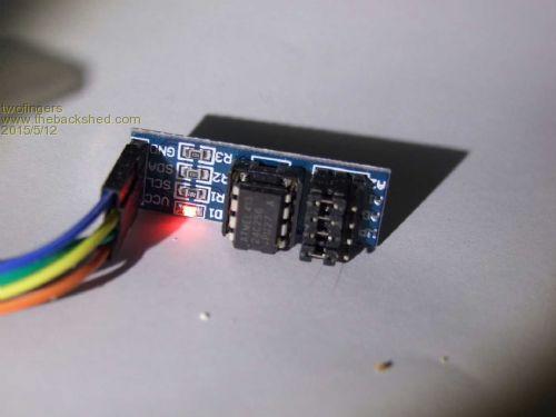

Someone here did a torture-test of an EEPROM chip a while back, and used a MM chip to count how many writes were done to the same address, until the EEPROM failed at that address, and I think that it was a very, very long time before failure.
torture-test
Michael

This could result in a more reliable code. Because sometimes WRITE works with a very short PAUSE and another time (depending on Vcc??) do I have the PAUSE to increase to avoid errors. Maybe ack polling will prevent this.
Michael
