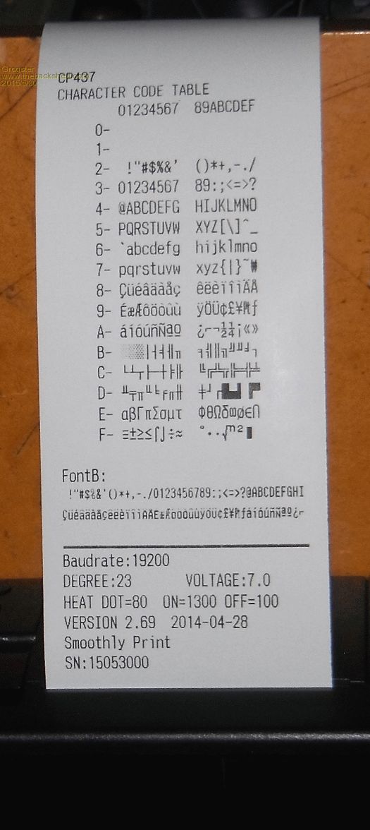

Posted: 10:52pm 07 May 2015

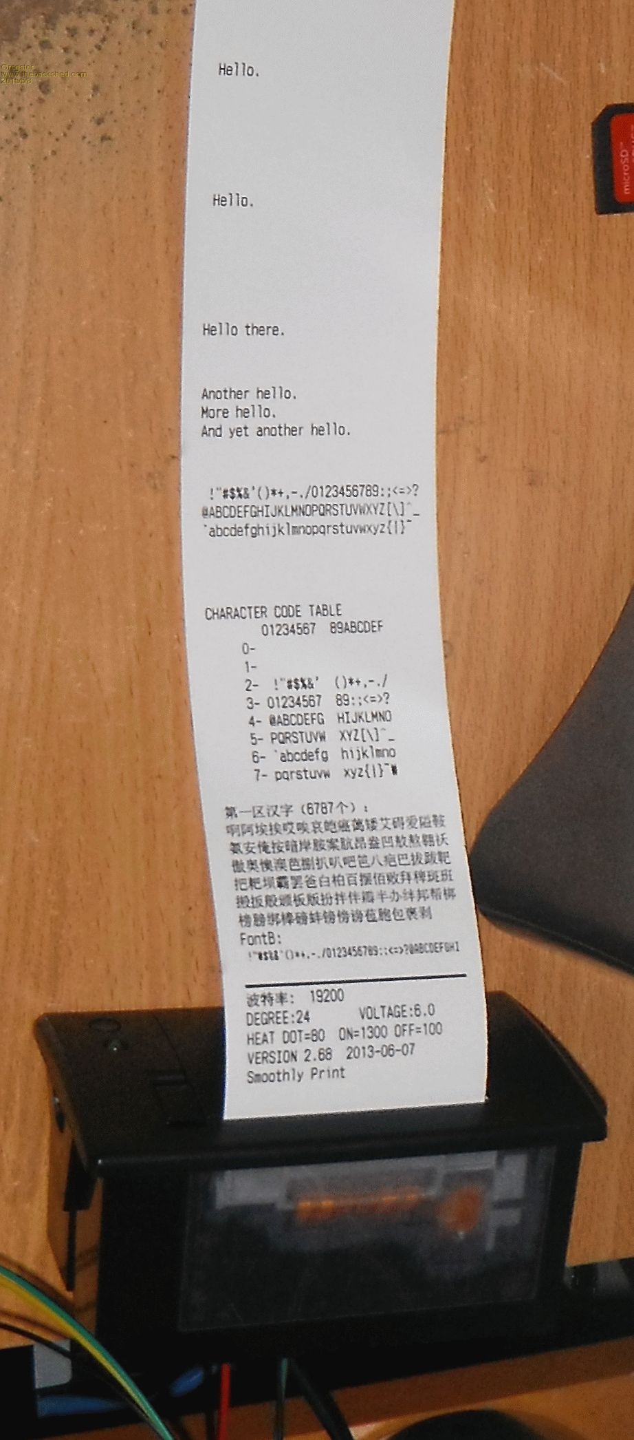

Here is a shot of the character set, along with a self-test print at the bottom.
You can have 32 characters per line in normal font.

Posted: 11:00pm 07 May 2015
Nice one G.
I see under your Chinese message to me that FontB is 41 characters per line (if my eyes are correct) and a leading space (or two). Is there another font offering 80(ish) characters per line?
This is just about readable in the photo but what is it like to read when it is front of your eyes (i.e. physically in your hands)?

Posted: 11:12pm 07 May 2015
@ astroboy: here is the link I got mine from, but WW also has a source.
@ WW: Can you please re-post YOUR link? I think it is exactly the same unit, but it would be good for other members to have options. As to the printout questions, I will make a short video so you can see(and hear) the printer in action, and will post a link to it soon.
Printout is extremely nice - very easy to read, not fuzzy or anything - just like any receipt you get at a shop. I have not played with the mini font yet, but that is next - you are right - that one gives more characters per line.
Character bytes 128-255 in the ASCII table are not the extended ASCII characters you might expect, but rather Chinese characters. The manual does go into how to re-define the characters, so one of the things I was looking at, was redefining some of those characters to the likes of extended ASCII for the single and double-line boxes(179-218). Not sure about this - depends on how easy or not it is to do, and how long it would take to send that data to the printer when you initialize it.

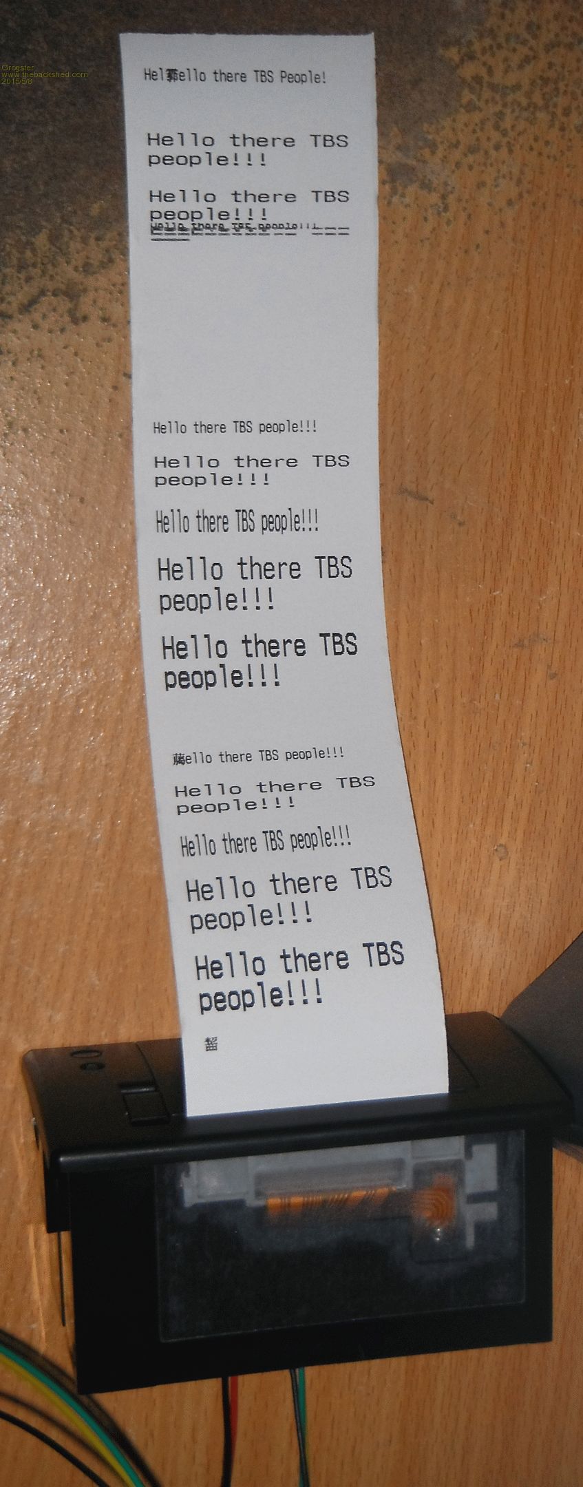

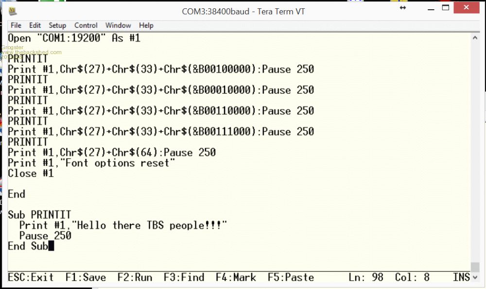

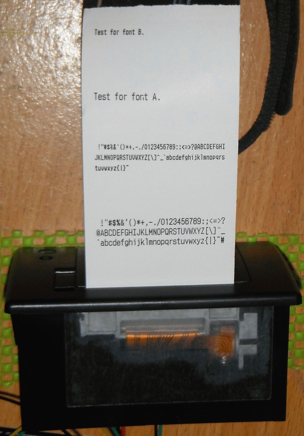

Posted: 01:19am 08 May 2015
I have found a better technical manual for this printer here.
Selecting Font B(the smaller one) is done by setting bit0 in the data byte of the ESC+33 command. Therefore, ? #1,CHR$(27)+CHR$(33)+CHR$(&B00000001) selects the smaller FontB. Clearing bit0 restores FontA(the default size).
Posted: 03:03am 08 May 2015
OK, 1AM here - need sleep.
However, good progress:
Print time for each full message is about one second, and it shows up well despite the relatively narrow paper size of 58mm. More tinkering tomorrow, but for now, my brain wants the company of a pillow.
