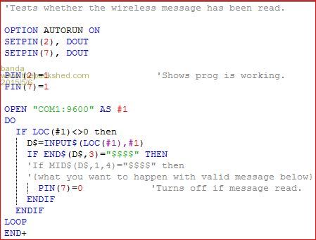

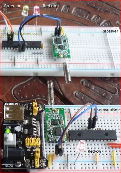

I'm back at my post again, fiddling. The prog is running. I've checked and rechecked but the green light doesn't go off. I've tried to program it so that if it has read the message the green light goes off.
I've given as much info as I can, and I would appreciate if someone can tell me why the green light stays on. I'm a beginner, so I won't understand technology that's too deep, says he pitifully.

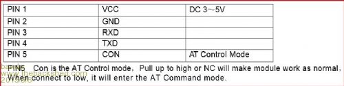

The module is an HC-11, and there is a Data Sheet, most of which I don't understand.

I would start by changing your END$ for something else like E$ - MMBASIC an plenty of other interpreter-type languages don't like you using keywords as variable names, and this MIGHT be the problem.
You also have a + at the end of your END statement at the very end of your TX code.
Other then that, I can't see anything obviously wrong, and I would expect that once the transmitter transmits, pin 7 should go low.
How can you confirm(or CAN you confirm) that the RF modules are actually transmitting?
Do the modules need any kind of configuration BEFORE you put them into use? Default settings of the RF module MUST match the baud-rate settings of the MM if you expect it to work. Many an RF module will have LED's on the module to indicate a TX or RX cycle. Not sure if those ones do.
EDIT: Pin5 of the module must be connected to Vcc(3v3 or 5v) to put the module into normal operation. I don't see anything on pin5, assuming a left-to-right numbering arrangement. Also, remember that TXD and RXD pins swap over between ends, so that means that TXD from the MM chip, needs to go to RXD on the module, and RXD from the MM chip needs to go to TXD on the module - same at both ends of the RF link.
EDIT: From what I can see, leaving pin5 on the module open is fine - that is normal mode, so ignore what I wrote above. Also, looking at your COM wires, looks correct to me, so when you transmit, you should get a transmission from the module at the TX end of things. Do you happen to have a radio scanner?
EDIT: Change END$ in the loop, to MID$. The way it is currently written, the data will never match, so that is what is stopping things. You probably should also get rid of the string of U characters from the TX code, as you are using smart-modules, and they will automatically add pre-amble, so just send the data you want.Edited by Grogster 2015-05-07

Not able to give you working code at the moment but your current code assumes that a full meif loc(#1)<>0 then
D$=input$(loc(#1),#1)
if mid$(D$,1,4)="$$$$" then ssage is available immediately. At 9600 baud, this is not going to happen.
You need to keep receiving data and adding it onto the end of a buffer until you have a full message (or enough to start processing)

Jim has an EXCELLENT point there. To explain his point a little more:
With the line IF LOC(#1)<>0 THEN, the problem that will happen, as Jim quite correctly is pointing out, is that as soon as there is a single byte in the buffer, the entire buffer will be read into D$, and more often then not, this will only be one byte in length(as LOC is now not equal to zero), and thus you never get four bytes to compare.

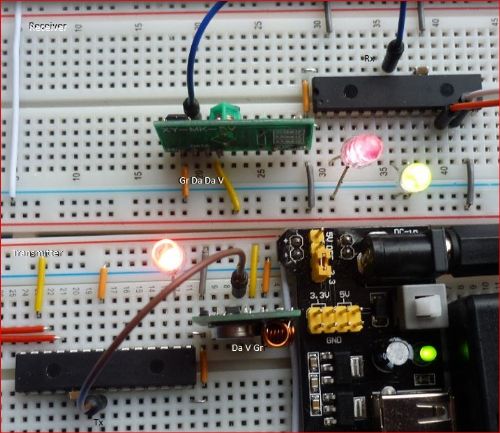

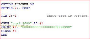

I'm starting to panic now. I've tried every variation of the help I've been given but still the green light stays on. I've moved them more than a metre apart also.
I've just received the new wireless pair (XY-MK-5V and FS1000A), so I tried them . I just replaced the HC-11 pair and connected the new ones as in the photo.
In the receiver I connected the data pin to Rx and the Transmitter data pin to Tx.
The green light stayed on.
I then connected them on the other way.
The green light still stayed on.
Having no Rx and Tx pins on the modules gave me much cause to pause and wonder.
I do admit to not having antennae on, but the built-in antennae are only 5 cm apart and my reading gave me hope that it should work. As well, 3 volts will apparently work on the short separation.
I'm still hoping that someone has built either of the two makes of wireless so I can follow their construction, or at least find where I'm making a boo-boo.
Who'd have thought that Micromite would be so involved? (Or me so dumb?)

Now that you have swapped modules to dumb ones, you will need the preamble back - the series of U's to sync the data-slicer in the receiver module. You did not need them for the first type of modules, as smart-modules take care of all that side of things for you. Cheap modules like the ones you are using now also should not really be run any faster then 2400 baud - 9600 baud is probably pushing it for those modules.
With the cheapies, there is no TXD and RXD pins, they are normally just labelled as "DATA", which on the transmitter module is the data input pin - goes to TXD on the MM chip, and "DATA" on the receiver module is the data out of the module, and usually is two separate pins, but either/or/both are the same connection - goes to RXD on the MM chip.
Setup the following code on your TRANSMITTER MM chip:
Open "COM1:2400" as #1
DO
Print #1, "UUUUUUUUUU$$$$XXXX" + CHR$(27)
Pause 2500
LOOP

From your photos above you appear to be driving the LEDs directly from the MicroMite pins. This is NOT good if you are using 'standard' LEDs (i.e. ones without built in current limiting resistors).
You need to put a single resistor either side of the LED. I prefer to use a resistor between the PIC pin and the LED (rather than between the LED and GND).
You may have damaged any outputs if excess current has been pulled due to the 'missing' current limiting resistor. Ideally when driving an LED with a '1' (high) you want to keep current flowing from the pin below 15mA. Use a resistor around 100ohms (but anything unto 1k will do for testing). The higher the value, the dimmer the LED will 'glow'.
To test if there is any damage, write a simple 'blink' program to test the pin (i.e. test Pin 7 with an LED AND resistor)
