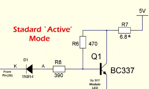

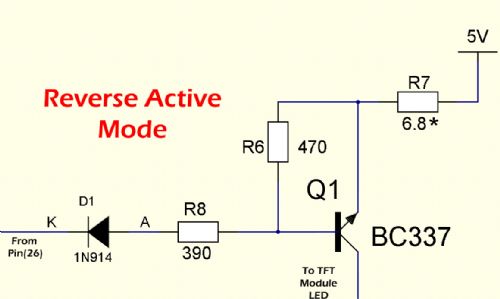

I then tried it with an NPN with collector to 5V and emitter to the LED and it didnt work.. in the process of swapping transistors around (My selection consisted of BC547, BC557 and BC337), I accidentally inserted my BC337 backwards so that it was as shown in the following image (which is the way that BackPack 170 is currently. It was `almost' perfect! After a couple of resistor value changes I got it working really well..
But Hey!! That transistor is BACKWARDs.. Thats not right.. But it works!! Hmmm what to do? So back to Dr. Google for reverse connected transistors and lo and behold it is not an uncommon design practice, there are heaps of references including this one from `Sparkfun' (search for Reverse Active).. So I released the board as it was, half comfortable with it..

This made the purist in me revisit the design, so I bread-boarded it again.. Proved that the REVERSE ACTIVE worked and worked well but this time I reversed the transistor into a more traditional layout and bugger me.. IT WORKED.. I have since built a BP170 with the transistor reversed (well in actuality NOT-Reversed) and can confirm it does indeed work.
Hmm, why didnt this work the first time I tried it?? I can only assume it had something to do with the breadboard design and some component not connecting to the holes in the breadboard correctly.. (I usually use solder proto boards but this time used those solder-less ones. I remember Phil's warnings about these a month or so back.. I can now concur with his sentiments.
What does all this mean?
Well it means that transistor, as shown, is actually backwards but does work and is unlikely to be damaged due to the low 5V max supply, and does seem to be a (at least semi) legitimate design. I will alter the manual to suggest mounting the transistor 180 degrees to get it to work in standard configuration.

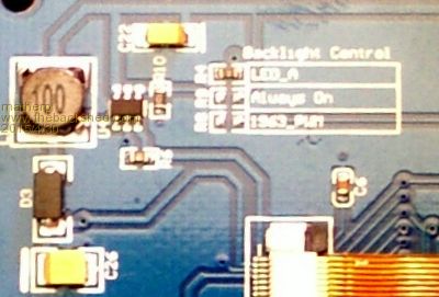

It is worth measuring the current going into the LED pin on any specific display before getting too clever with this.
On some displays (e.g. the SSD1963 mounted boards) the LED pin is a logic signal that switches a circuit that actually drives the display. It draws almost no current. It is perfectly OK with this display to connect "LED" directly to a PWM pin on the Micromite and use this to set the backlight.
In fact the SSD1963 controller has its own PWM output which is optionally selectable on the SSD1963 PCB.
The initialisation code for the SSD1963 in the ARMmite and the MX470 turns on this PWM and sets it to a level that on my display gave optimum brightness for minimum duty cycle. At some stage I'll write some code to expose this facility as a user function.

Mick: i'm a little confused by by your explanation. am i right in saying you were at first attempting to use an NPN transistor with collector to 5v, and load strung between emitter and ground? this will definitely NOT work, as the emitter can never rise above (Vbase - 0.6) volts - ie, you'll get approximately 2.7v (or a bit less) across the LEDs if the base is driven by a micromite output pin that can go no higher than 3.3v. this will light your LEDs dimly (as you have observed).
furthermore, with correctly driven base and less than 100mA collector current, i would expect the Vce of a BC547 to be quite low, according to one datasheet: with Ic=100mA and Ib=5mA, Vce(sat)=250mV typical.
from where i am, it seems you should be using your "reverse active mode" circuit with a PNP transistor in place of the BC337, emitter to 5v, R7 bridged, R8 about 1k5. if pin 26 is set to 'open collector' output, then D1 will probably not be needed.
when used as switches, it is safest to use an NPN transistor to switch the low side, or use a PNP transistor to switch the high side. if Vload is higher than Vmicro, then use 2 transistors when switching the high side - a PNP transistor to switch the load, and an NPN transistor to switch the base drive to the PNP one.
and remember - the base voltage of a bipolar transistor is quite entitled to be higher than the collector voltage; whereas valves (and FETs) are voltage-mode devices, bipolar transistors are current-mode.
rob :-)

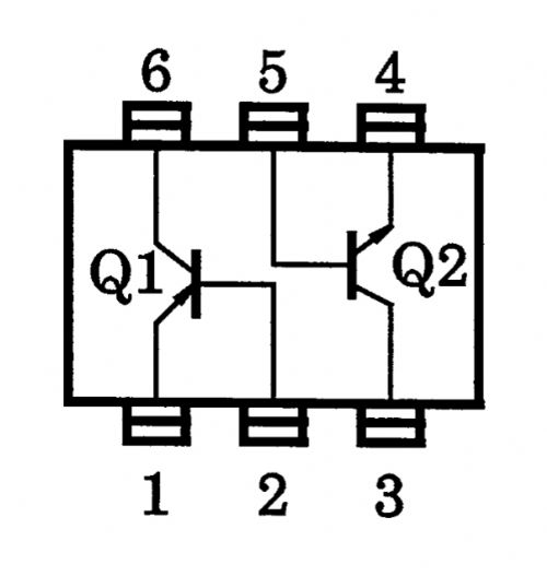

In reality I agree a 2 transistor circuit would have been better but I didnt have the room for 2 transistors and all the bias resistors unless I went SMD which I tried to avoid. I have these neat little SMD chips (3mm x 2mm that have the follwing footprint but these would have made the board difficult to solder for many people.

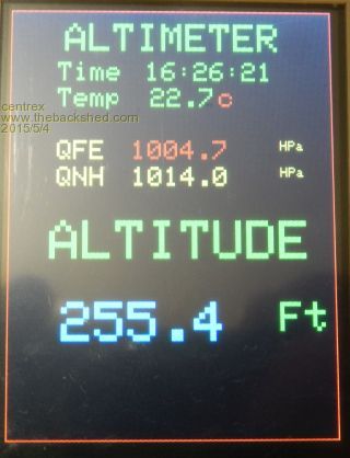

One thing to remember the tft modules Mick's board is designed for runs at 3.3volts.Mick's revised circuit while switching the 5volt railensures that only 3.2 volts ends up on the led pin.
I have it running just a single led with no problems as a test.
Bigmicks driver board matherp software driver BMP80 pressure sensor, my altitude a bit south west of Sydney.
