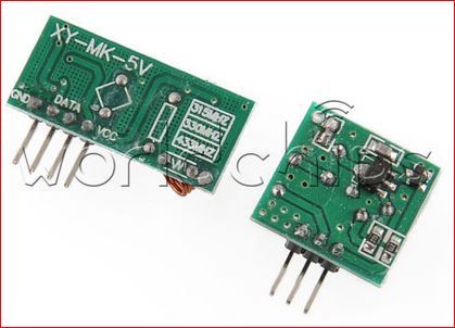

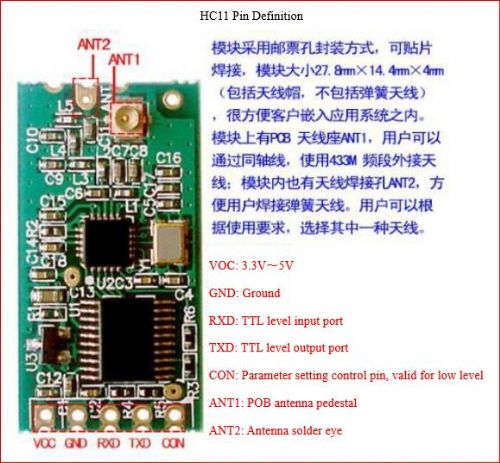

HOWEVER, I think I'm now about to box above my weight because I want to read data wirelessly, sent from outside the house say. I already have a pair of transceivers,
HC-11 433MHz wireless RF serial UART, unused because I defected to micromite,
and as well I've ordered the following,
433Mhz RF transmitter and receiver kit Module
I'm always amazed at how arcane the cross-flow of information is on the forum. It's mostly an alien language to me, so here's my plea.
Is there anyone out there as simple as me (or anyone) who has a simple program that makes transceivers work? I'm good at analysing a working model.
Thanks for ANY advice.

I agree with Bryan on this one, and I have not had a great success rate with those super-cheap RF modules. From what I gather, they DO work, but don't expect it to be easy, depending on module.
I tend to use only Radiometrix or SunrayRF modules, but they are about US$20 each - or more depending on wanted power output etc.
The one major advantage of the more costly modules is that they are more likely to work right out of the box, and will most likely be type-approved.
However, if you wanted to try something with the cheap modules you have, you would need to setup two bits of code - one on the transmitter, the other on the receiver to form the data link.
Most "Dumb" modules(modules that have no processing on-board, they just transmitt the data sent into them) will tend to need some pre-amble bytes to help sync the data-slicer in the receiver end of things. This is normally done with capital U characters, as this represents 8 bits of alternating zeros and ones, which allows the data slicer to sync to the data stream. You also tend to need some kind of qualifier in the data, so the receiving end knows the message is for it.

Also worth noting is that smart modules don't need these U's - the first modules in your photos look like this type, but I don't have any of those.
This is a very simplistic look at how to drive RF modules just so you can see how it can be done, but I can help you if you like - I have done a lot of RF module work with the MM and Picaxe chips.
