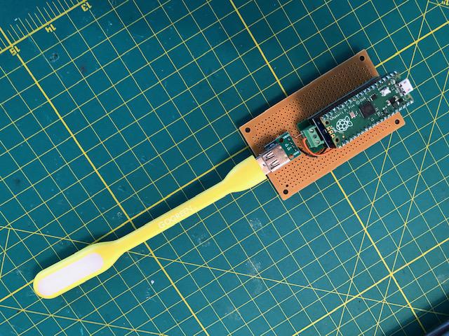

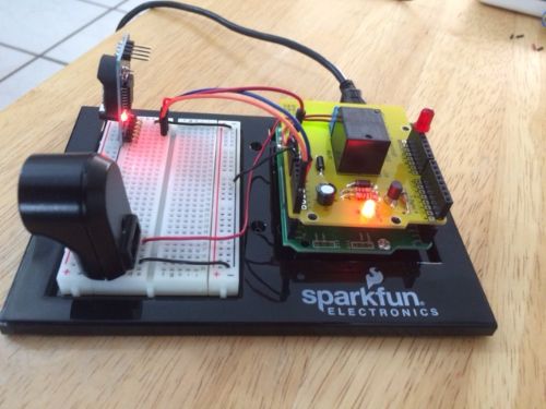

This post describes an automatic Micromite-based night light. It determines the time to turn a night light on and off using an algorithm that computes rise and set of the sun for any day of the year.
The following is a picture of the night light. The RTC and LED are on the left. The CircuitGizmos CGMICROBOARD1 Micromite and Mad Evil Scientist simple relay shield are on the right. The red LED on the right header is a status LED that flashes every 30 seconds to indicate the algorithm is running.

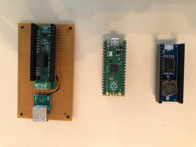

I have updated the automatic night light project to use the Explore-28 module and the latest version of MMBASIC.

Here's a Picomite version of the nightlight.
In this picture, an OONO relay module is on the left, the Pico in the middle and a Waveshare RTC to the right. Power switched by the relay is taken from the OONO VBUS pin as is a ground connection for the LED light. Pico pin 1 controls the relay and the heartbeat LED on the Pico is flashed every 10 seconds by the MMBASIC code to indicate the software is running.
Components are stacked from bottom to top as relay, RTC and Pico as shown in this picture. The LED is connected via a small USB breakout board. Everything mounted on a small perf-board I had in a circuit board drawer.

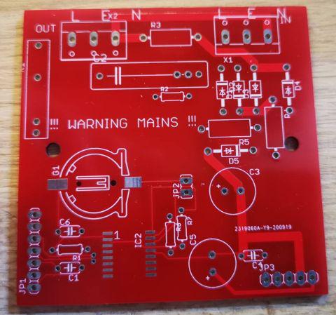

I have been manufacturing a dusk2dawn light for a while which uses an SSR to switch a mains load.
Whereas the routine to calculate the sunset/rise times above is very precise, my method was to calculate the times by interpolating between 13 data statements (much smaller & faster). It is a blunt instrument but as I use "civil twilight" it doesn't have to be terribly accurate. in practice it is about +/- 5 minutes and the light comes on as you would expect. It is nice not to have to either adjust timers or use light sensing - a purely computed decision. And the "fuzziness" (by which I mean it uses twilight not darkness) of the switch on time covers drift in the RTC. The prototype has been operational for years and I haven't tweaked the clock once.
here is a pic of an earlier version PCB, RTC on the top, uM on the bottom. It really is plug in and forget.
JP3 is a header for a RCWL0516 microwave movement sensor, (which provides the 3V3 from the 5V6 Zener voltage) and movement detection. The light comes on at dusk and goes off at 23:00(non DST) and will come on for a period if movement is detected (having been de-glitched - I like the '0516 - much greater range that IR jobbies and can see thru walls - but it is affected by bushes moving in the wind). The later version has a neater PSU and jumpers for no RCWL0516 so giving true d2d if required. JP1 is a combined console and flashing connector. One "drawback"; the unit must be connected through an isolation transformer when on the bench as any mains powered device will trip the MCB as soon as you connect the ground reference - a "feature" of the PSU design. No such problem for handheld kit.
The IsDaylight() function can be found here. In its simplest form, it returns a flag so
