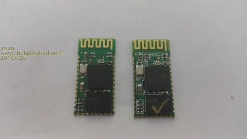

I have found 3 different versions all based on the same hardware
HC-05 the preferred option
HC-06 limited to slave mode only
BT04 Different AT command structure so incompatible with HC-05 software
See the pic below the one on left is the BT04 (they look exactly the same)

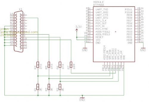

LPT port SPI programmer as per the schematic below

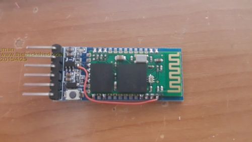

To make it easier to handle carrier PCB's are been used these provide an easy way to power and connect the modules to your device. One short fall is that the EN pin of the carrier PCB is used to enable the power supply and does not put the module into command mode this is done with a push button on the carrier PCB. To solve this you need to remove a SMD resistor and add a wire link as per the picture below. This now allows the command mode to selected via software and a I/O pin.

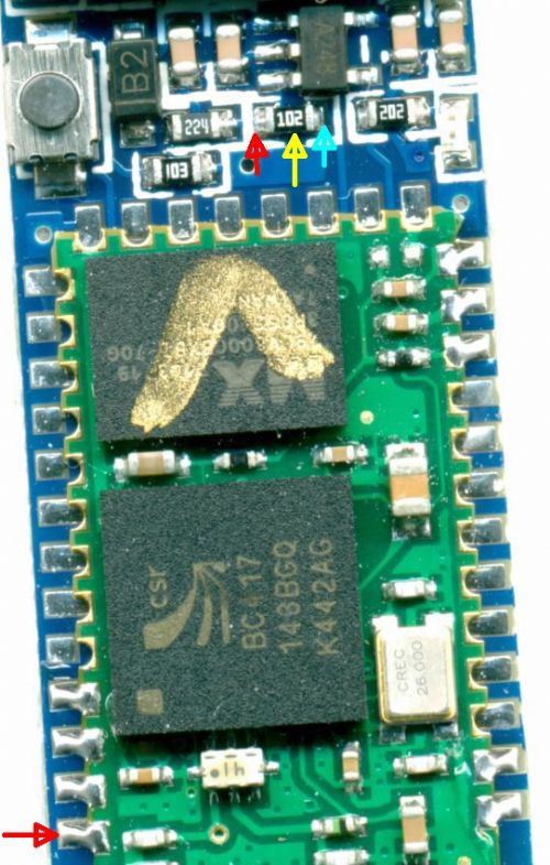

See the image. Can you be more precise about the resistor to be removed and the location of the wire. I think you are talking about the resistor at the yellow arrow. Where to attach the wire?
Bob
Posted: 01:39am 14 Jun 2015
Looks to me like in jman's original image, the wire link is soldered to the point marked by the cyan arrow in your image above. I also agree that he is meaning the resistor at the yellow arrow point.

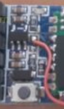

Posted: 01:53am 14 Jun 2015
Grogs
I had an inspiration. I copied the image from the forum. Expanded it to full size of a 24" screen and then snipped a copy and you are correct. See the fuzzy image.
Bob

  BobD said   Jman
Bob
Correct resistor
Yellow wire goes the resistor pad furthest from the button cyan arrow
Attached a better pic
