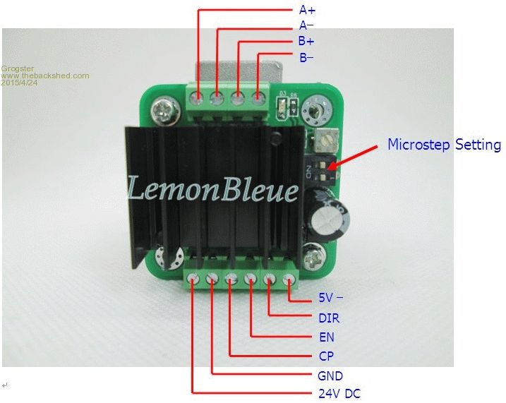

Image from the eBay listing gives this wiring:

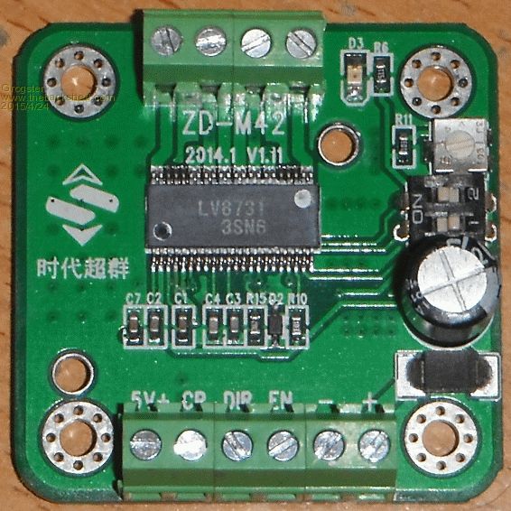

Now, I removed the heatsink mainly so I could see if the driver IC had a marking(it did) so I could research the chip, and what do I find on the silkscreen under the heatsink? (rhetorical)
Notice the totally different pinout from the graphic on the eBay listing?
I will hook the motor back up to the driver with just the button for a start, and I HOPE it will work. Due to the wrong wiring diagram, this module may be fried, as I have been applying 13.8v to the left-most bottom connection, which is actually the 5v logic supply, so I might have cooked the module cos of their wrong diagram.
The image on the listing is TOTALLY wrong. The PCB silkscreen ID appears to be correct, following the tracks.
Stay tuned - I will test this now, and post back with the results - wish me luck! Edited by Grogster 2015-04-25

Funny how when you use the correct wiring, the bloody thing works, for God's sake....
I will email the seller that their diagram is totally wrong.
If I follow the silkscreen, I can have full control of the speed of the stepper from zero to full speed.
