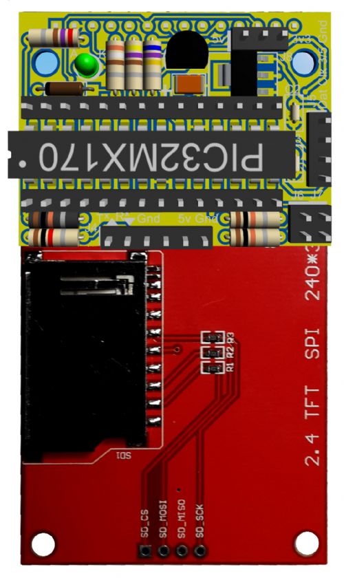

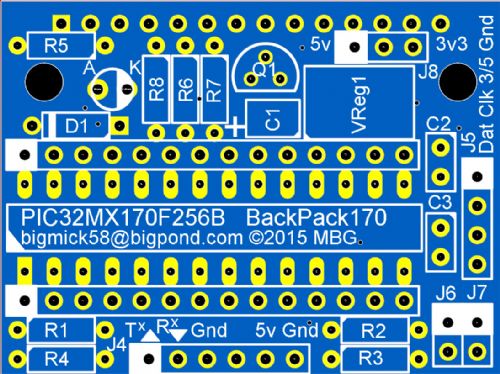

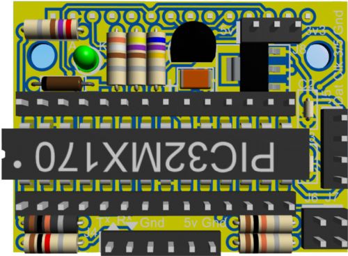

Some pictures..
Overlay
3D representation
Mockup of how it would look on an SPI panel

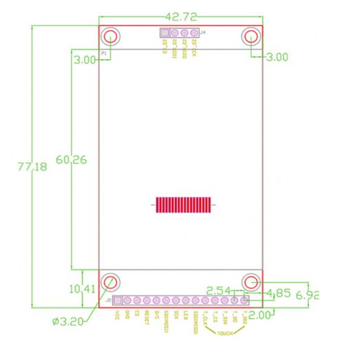

Eh mate what are the dimensions of that 2.4" tft screen mate as I do have a Hammond Case here waiting for the best solution.
Cheers Bryan
Posted: 02:38am 10 Apr 2015
Hi Bryan,
Here are the physical specs for the display I used... The 2.8" unit is larger and within a $1 of the 2.4" display..
I added it to a ZIP file so the details can be seen easier
2015-04-10_123759_SPI.zip

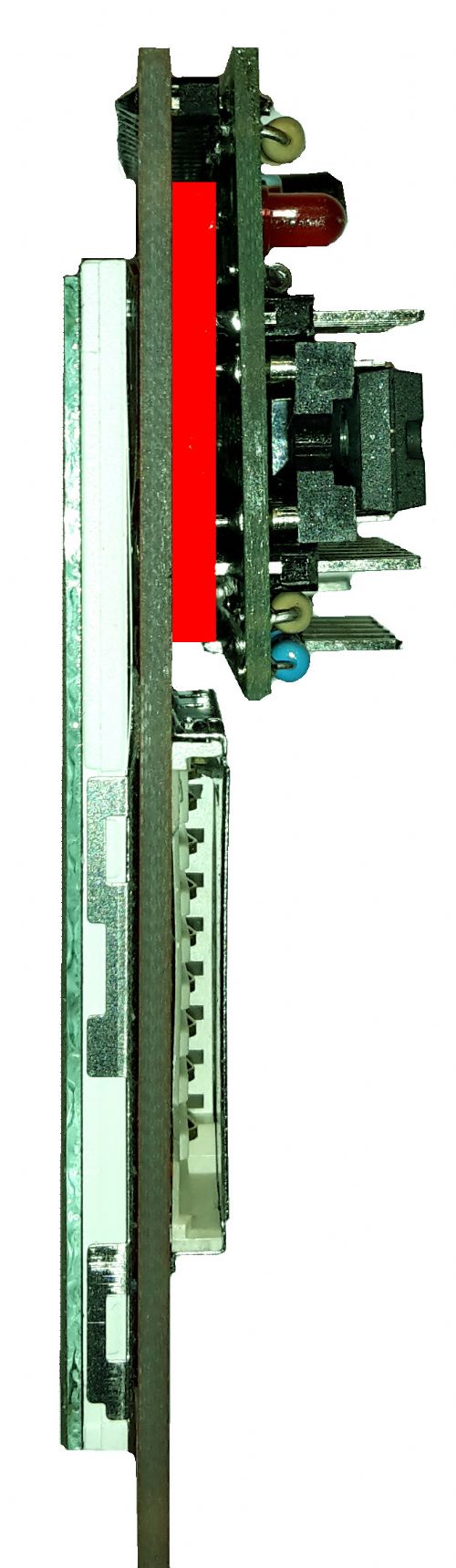

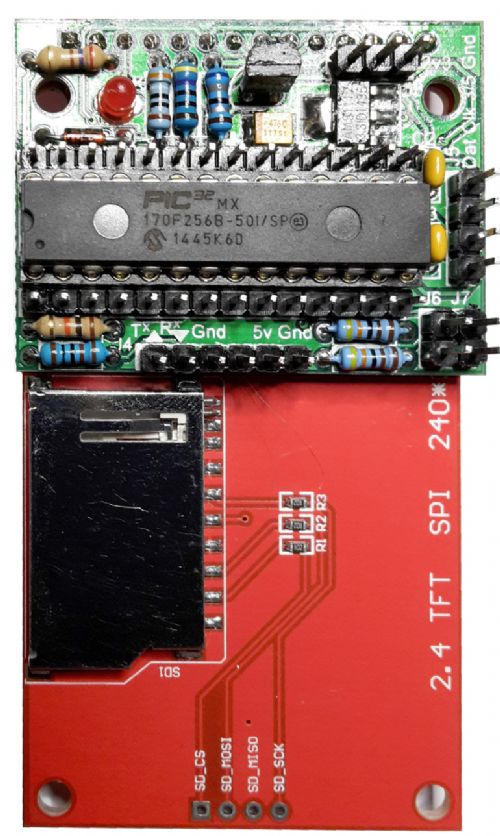

Just letting you all know that my Backpack170 PCBs arrived today and I have to admit I love them.
It worked `out of the box'..
I haven't yet done a manual but hope to get one out in the next couple of days..
When I have the manual I will add it to my `Micks Blatant Self Promotions' page.
A couple of pretty terrible pictures to show how it looks, the picture makes it look quite a lot wider than the screen , in fact it is only about 1mm wider than the screen. I have tried to use Through hole parts but I have opted for the SMD Vreg and the SMD VCap (a must anyway) as this has worked extremely well in my MuP boards. Of course I will be offering options of these two parts pre-soldered for those still a bit wary of SMD..
Note the Red block is showing where I used double sided foam tape to try to avoid any shorts between the boards, I probably suggest some sharkskin or tough plastic to fully insulate in the case of very rough treatment.
