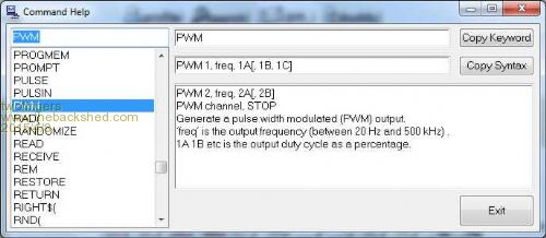

I didn't know about the MMedit-Help till today:
You will find more info on page 54 of the uM MMbasic manual.
