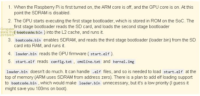

EDIT: I've done a little reading on the PI bootup thing, and found this on the net:
Edited by Grogster 2015-04-06

Well, its certainly a tangled web at boot time.
But this "binary blob" (bootcode.bin) is no secret. So perhaps it would not hinder someone porting the code?

Isn't the secret all of the hardware? I thought that interfacing to the broadcom hardware was not public code?
