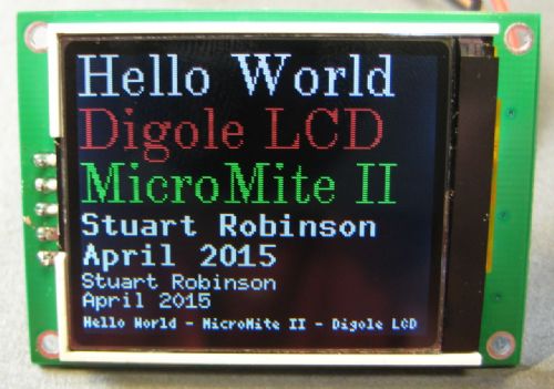

Here are some routines to drive the Digole Serial LCDs with a Micromite II.
This particular Digole LCD is 160x128 pixels, display area around 40mmx30mm, and it runs from 3V3.
Advantage of the displays is that they only need one I\O pin to drive them, so very easy to add to a project.
