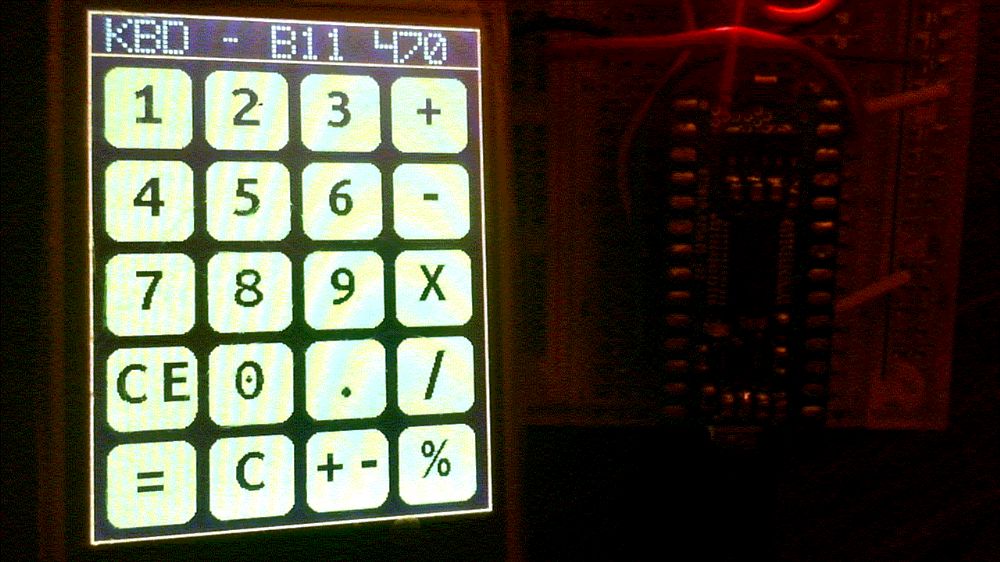

I got the B11 code shot, and was testing out the new embedded graphics stuff...
So, let's get the ball rolling with this
It's not much yet, but by playing around with the front settings, you can create different size layouts
Dim integer ksize=49
Dim integer kspace=8
Dim integer kColor=green
Dim integer kRad=8
Dim integer toffX=12
Dim integer toffY=8
Dim integer tfont=4
Dim integer tFColor=black
Dim integer tBColor=green
Dim integer gutterX=10
Dim integer gutterY=35
2015-03-23_025946_2-4inch_LCD_KBD_B11_470.zip
If you have the SPI 2.4" touch display, give it a play...

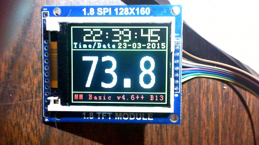

Thanks to Matherp, the 1.8" TFT LCD using the S6D02A1 controller is now supported..!
I penned up a simple time - temp program to test the newly supported unit...
2015-03-24_035743_1-8inch_LCD_B13_470.zip
However, while playing with it, the firmware seems to have the DS18B20 bug
where the displayed temp goes wonkey if the temp gets above 82 F...
All in all, a good nights work... Yikes, past my bedtime... More later...
Posts: 12071
Posted: 10:07pm 23 Mar 2015
  Quote  However, while playing with it, the firmware seems to have the DS18B20 bug
This is a bug reading the DS18B20 when CPU speed is 96 - works at 80 and below. I've had a look at it. 96Mhz is a special case as the CPU introduces a wait state for peripherals at that speed but not below but not apparently for the core clock used for timing usec pauses
In general peripheral intensive applications will work faster at 80Mhz than 96 although the difference may be not obvious from Basic.
Bug fix posted
Glad the S6D02A1 works OK Edited by matherp 2015-03-25

Sorry Matherp... I forgot about the speed thing... Very happy guy here..!
All the new things coming out is just amazing..! will get the Discovery board testing done next...Edited by Zonker 2015-03-25
