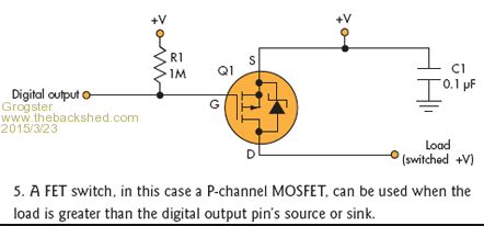

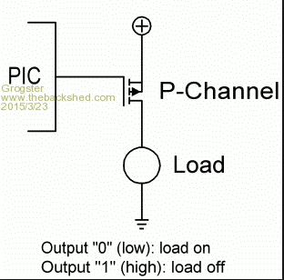

So, I was looking at using a P-channel MOSFET as a high-side switch, rather then a PNP transistor. The concept would appear to be the same:
Logic low will switch the load on, logic high will switch the load off.
Other then standard voltage and current ratings of the MOSFET, is there anything else I need to know to be able to use them?
This one was the one I was thinking of using.
Supply voltage is 3v3, load current of the transmitter is 50mA or less.
As this MOSFET has a S-D resistance of 0.1 ohms, which is about standard, I should have practically no voltage-drop to the 3v transmitter module, if I use a MOSFET rather then a PNP transistor.
As MOSFETS have such high-impedance gate's, I see some circuits(like the image above I stole from Google Images) that don't bother with the equivalent of a current limiting base resistor. Is that standard practice?

This image shows the internal diode, so it would be source to 3v3, drain to the RF module 3v3 supply input.

the problem with your MOSFET circuit is that if power to the PIC is lost, then the MOSFET will turn on. similarly, the transmitter supply voltage can not be any higher than the PIC's supply, which may be a limitation.

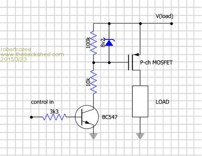

to use a MOSFET you need to use two transistors. an NPN transistor to create an open-collector output, then the P-ch MOSFET with a pullup on the gate. if the transmitter supply is more than about 8v you will also need a zener diode to protect the gate from excessive voltage.
rob :-)Edited by robert.rozee 2015-03-24

the following circuit is something i've used in the past, most recently to test the drop-out time for some mobile (13.8v) radio products - the company wanted to see how long a supply drop-out could be before the radio reset itself. the P-ch MOSFET i used was a bigun, needing to be able to switch something like 25A with minimal loss. the control signal came from an HP signal generator that allowed the creation of very precise negative-going pulses to simulate the dropout condition:

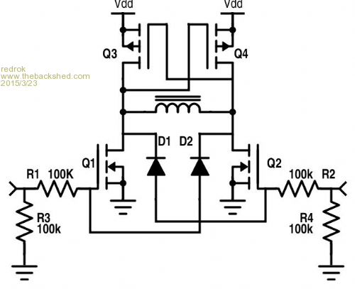

I know your circuitry is already designed but I would be remiss if I didn't show a very nice all MOSFET H-Bridge:
The high side DMP2215L-7 MOSFET would work well at 3.3V.
The 2 diodes guarantee minimal shoot through in case both MOSFETs are enabled at the same time.
When running it at higher voltages make sure the high side MOSFET maximum gate voltage is not exceeded.
redrok
Sorry, I posted this in the wrong thread.
redrokEdited by redrok 2015-03-24
