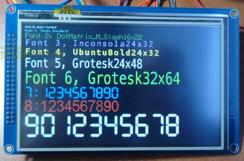

The other main change in this release is the implementation of in-built graphics routines. The following controllers are currently supported:
Parallel
ILI9341P : many 2.4" and 2.8" displays with an 8-bit parallel interface
ST7781 : other 2.4" displays with an 8-bit parallel interface
SSD1289 : 3.2" displays with a 16-bit parallel interface
SSD1963 : 5" and 7" displays with a 16-bit parallel interface
SPI
SSD1351 : Colour Oled displays with an SPI interface
ILI9341S : many 2.4" and 2.8" displays with a SPI interface
ST7735 : 1.8" displays with an SPI interface

Once the display is open there are a range of drawing commands available:
DISPLAY font, xstart, ystart, foreground colour, background colour, textstring, (optional x-scale, or x and y if only this parameter specified),(Optional y-scale)
10 fonts are currently included as shown in the picture. The code includes wordwrap and protection against writing outside the screen area. All fonts can be scaled using the x-scale and y-scale parameters but note this does introduce a performance overhead.

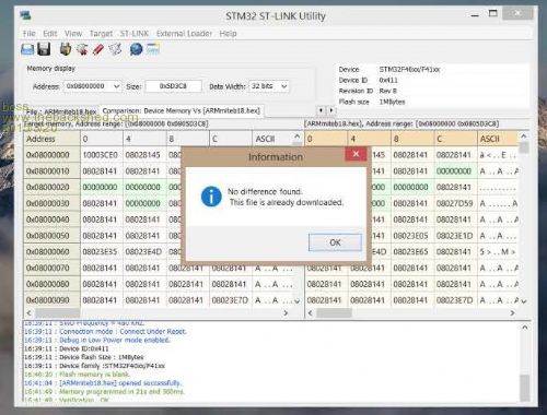

@matherp
Boot x VDD connected, the chip was completely erased, then flashed and verified. The result is the same. Everything looks fine, even flash x file verification (see picture). No other problem was found yet, but embedded Editor.
Bo

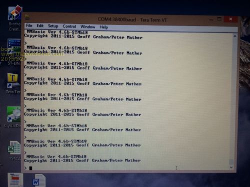

Posted: 04:44am 21 Mar 2015
@matherp
Terraterm 4.86 and W 8.1 pro. It behaves madly. Greeting message prints 9 times, the reset button seems not working now. I'll install one more disk and try it again with fresh installed W7. What kind od Windows you have installed? Could virus infect hex file? I don't know. b12 seems working fine.
Bo
Posts: 12071
Posted: 05:57am 21 Mar 2015
  Quote  Greeting message prints 9 times, the reset button seems not working now
That sounds like the reset pull-up resistor is missing/dry joint
I'm using W7 64-bit, Teraterm 4.82, FTDI (possibly) adapter
Also, make sure you are only using three wires from the USB/TTL adapter, GND, RX, TX - you don't want to connect VCC
Attached is a version of b19 that should default to USB rather than UART for the console
2015-03-21_160543_ARMmiteb19USB.zip Edited by matherp 2015-03-22

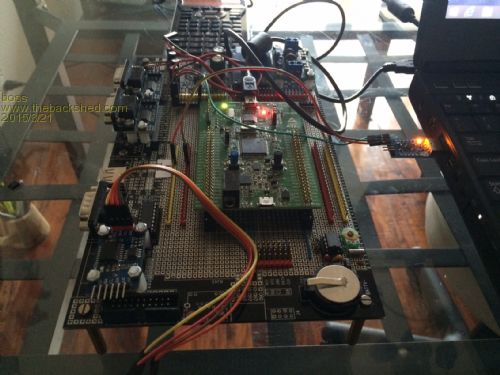

@matherp
All mine FTDI went to the garbage can as I decided upgrade to 8.1 and FTDI doesn't support it under W8. I switched to CP210x and they working fine.
there are some picture, the Discovery board is firmly inserted in big prototype board, there could be absolutely no Discovery board damage
Hope that iPhone didn't flip picture upside down as happened last time
Will continue with W7
Bo
Posts: 12071
Posted: 08:04am 21 Mar 2015
I can only suspect something about your proto board is shorting out the NRST and GND pins - this is definitely not a software issue

Can you unplug the Discovery from the protoboard? Then remove the shorting link SB11 on the bottom, also the two ST-LINK jumpers on the top. That will disconnect the st-link from the 407. Then just connect the RX, TX, and GND from the CP210x and the USB into CN1 to power it up. That eliminates all outside influences
boss

Posted: 01:03pm 21 Mar 2015
@matherp
I did as recommended and the result was the same then reconnect the jumpers back, erased, re-flashed and the result was same.
I believe it happened when I put jumper between boot0 x VDD fleshed then probably forgot remove this jumper.
Bo
