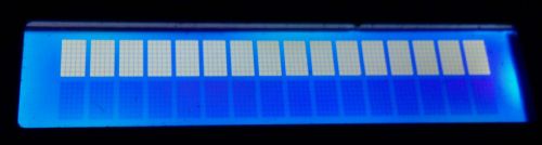

On powerup the LCD shows blue, with one line of 16 dark rectangles. None on line 2.
Nothing changes when the prog is run.

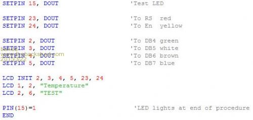

My little prog. The red LED lights at the end of the run program.

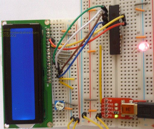

The layout, as clearly as I can. The LED is alight.

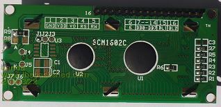

The underside of my LCD.
Why doesn't the stupid LCD show the text?
Banda

Looking at the layout there are just two things I am looking at regarding the 10k pot:
Is the 10K pot wired correctly across the supply (two ends of the 10k pot; and is the 'wiper' going to pin3?
The next thing to check is continuity between each pins - check for open circuit either in a lead or a 'bad' breadboard contact strip!

I looked at your link wiring and it looks correct to me.. The one question I ask is the low order bits DB0-DB3 you have linked to GND.. I have always left these floating (presumably pulled HIGH) and that may be your problem..
If you rotate the pot and can see full black rectangles usually on the TOP row only and then can fade them to nothing I reckon the pot is fine... you could rotate till you see the rectangles lit and see if they change to two lines (dimmer) which means the init routine works.
Try pulling the GNDs on the low order data and see how you go. If that doesn't work I would try buzzing from the uMite to the LCD module to make sure every wire is intact.

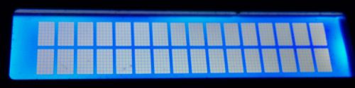

OK I've taken those 4 GNDs out, but no result to the prog. If I was paid I could say that there is the faintest, and I mean faintest, shadow of another line of rectangles. They might even have been there before and I hadn't noticed them.
