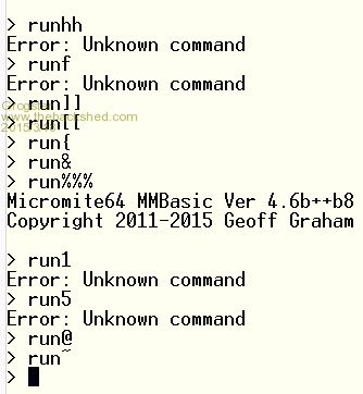

This is interesting.
Not fatal, just odd.
run command with symbols on the end does not result in an error, and code still runs.
All other typos cause an error as expected.

You can probably find the same thing on other single commands if you try.
The biggest overhead in MMBasic is the interpreter i.e. reading each Basic statement. With a command like RUN, once the interpreter finds the valid sequence RUN followed by a non alphanumeric it is happy and executes as there are no valid parameters. Hence RUN5 isn't the same as RUN but RUN! is.
Not a bug - just a feature and probably common to every platform
