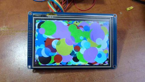

With Geoff's agreement I've implemented various graphics drivers as part of the core Basic language on the ARMmite
You can see the demo on YouTube
The code running this is:
dim integer BLACK = &H0000 ' Color definitions: 16 bit (RGB565) colour palette so these are just examples
dim integer BLUE = &H001F
dim integer RED = &HF800
dim integer GREEN = &H07E0
dim integer CYAN = &H07FF
dim integer MAGENTA=&HF81F
dim integer YELLOW= &HFFE0
dim integer WHITE = &HFFFF
dim integer x,y,r,rc
dim c(7)=(black,blue,red,green,cyan,magenta,yellow,white)
'controller, command/data pin, WR pin, reset pin, no.bits, screen width, screen height
display open ssd1963,1,2,3,16,800,480
do
x=rnd*800
y=rnd*480
r=rnd*100
rc=rnd*8
if x-r>=0 and x+r<800 and y-r>=0 and y+r<480 and rc<8 and r>1 then circle x,y,r,c(rc),f
loop

Time to write a complete screen on the SSD1963 (800 x 480 x 16bits) 73msec

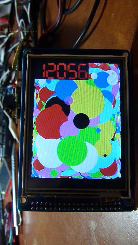

I've just added the SSD1289 display controller to the code. This is the "value" TFT: 3.2in, 16-bit parallel interface, 240x320 resolution.
On this video I put a counter of circles drawn - It is fast 15msec for a complete screen draw and NO CFUNCTIONS needed!
Edited by matherp 2015-03-16

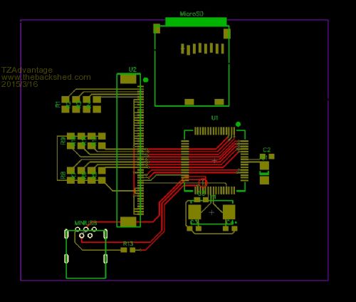

Posted: 08:38pm 15 Mar 2015
Board in early design.
Fits on the back of a 2.4". It will run a VT100 terminal. PCB is same width as an arduino uno so that it can be used as a shield. The chip is a PIC32MX470MX512.
This is for a larger project i am working on, but will allow easy addition of a screen to a uMite or any other mcu with serial or i2c connection. (It can be used standalone also.)
2 pins is all you need, and same as Geoff's vt100 it will also act as a USB-Serial.

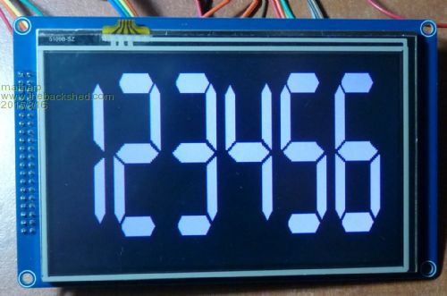

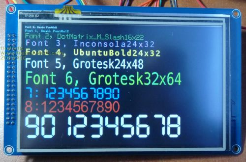

I don't know how many of these will survive Geoff's cull but these are the fonts I've got loaded on the ARMmite - display is the 5" SSD1963 800x480.
The biggest numerical font is 64x100 pixels.
I remember someone was looking for very large numbers for a clock for someone partially sighted - might these do the job?

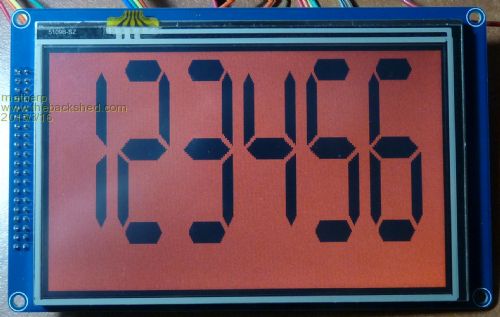

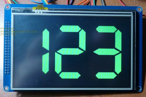

Posts: 12071
Posted: 10:07am 16 Mar 2015
OK, so I lied
This big enough? Just don't ask for anti-aliaising
