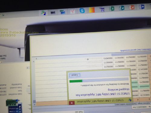

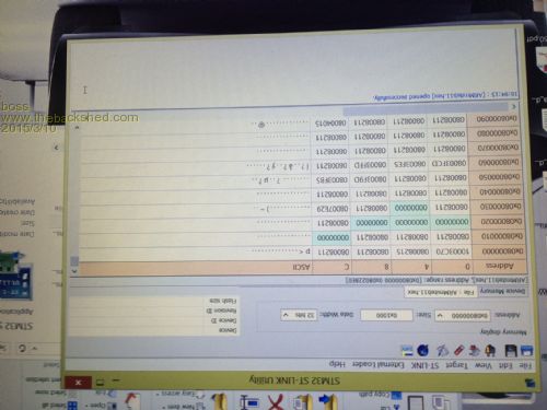

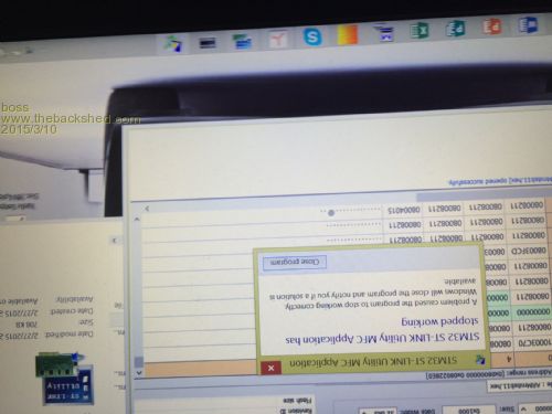

Has anyone ST-Link running on Win 8.1? Damn, I upgraded all my comps to 8.1 and I'm able to upgrade FW via ST-link, but nothing else. So the communication basically works, but nothing else.
Any suggestion will be appreciated.
Bo

Joined: 19/08/2011
Posts: 268
Posted: 01:29pm 10 Mar 2015
I apologize for misplaced pictures, I sent the pictures from my iPhone and did't realize they are upside down.

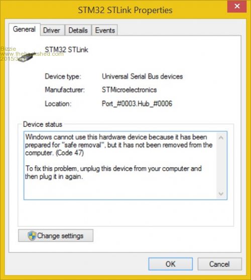

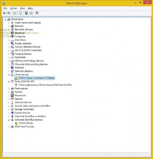

I have purchased a STM32F4 Discovery I have it working using a USB/serial adapter.
I have downloaded and installed the "STM Serial Port Driver " (win 8.1) all went has normal. I have a serial bus device called STM32 STlink in device manager.
Now the embarrassing bit I can not remember how to find what com port it is connected to!
An update!
A reboot of my system resulted in a windows update (yet another worry with 8.1!).
I now have a device driver tree that looks like this :-
Properties page shows :-
A search for the driver says it is up to date. As usual solution does not make any difference.
Latest Update :-
Will not include a screen dump. I uninstalled the drivers and then manually installed them by pointing the driver update to the folder C:\Program Files (x86)\STMicroelectronics
All seems OK BUT I have no communication with the STM32 from either terra term via ST-LINK (comm5) or the STM32 ST-LINK Utility AND if I pull the plug on the USB console I can not see the STM32 from TT via the USART.
So I can go no further with out some ideas.

You do have two USB cables connected? the Mini-USB is for power and the Micro-USB (near the audio socket) is for serial comms.

Yes,
It is very interesting that connecting the "power USB", the one with the red led's either side shows a usb connection in my system tray!
Connecting the other USB (near audio conn.) makes a sound on the PC, this is also the case when I press the black reset button on the STM32.

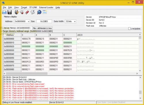

I think I have progressed!!? - Have regained connection with the STM32, switched off and went to dinner.
I now can not erase the STM32's memory :-
I tried both a complete erase and by sector, note error during sector erases.
Just tried loading STM32B10.hex after another unsuccessful clear memory. I now have Ver. B10 running fine so will play with that for a while and try Ver. B11 later.Edited by Bizzie 2015-03-12

  Quote  I tried both a complete erase and by sector, note error during sector erases.
Try "Target/Setting/Mode/Connect under reset" when programming.

Posted: 12:32am 11 Mar 2015
That is the mode I have been using. If I try any other mode the STM32 ST-utility says it can not connect to use "Connect under reset".
Matherp, it seems the memory command has not been implemented, is that correct? It causes a lockup of my system I have to use the reset button to regain control.

Posted: 12:42am 11 Mar 2015
You can also try putting a jumper between BOOT0 and VDD.
Just tested and "memory" works fine on both B10 and B12 using the hex files on the web and programming with ST-LINK so I assume you are not getting the chip properly erased. It must be fully erased before programming as the options are stored in sector 11 and they are different in the different versions.
