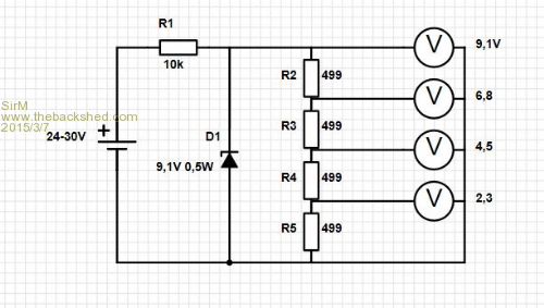

Hi all
Am I thinking right here?

@Sir_M
Nothing wrong with your circuit. What is the purpose for?

Hi Sir_M;
  Sir_M said   Hi all
No.
The four 499 ohm resistors in series draw quite a bit of current. So much so there will be none left to go through the regulating zener.
I would suggest raising R2...R5 to 2K each.
Or
R1 can be lowered to 2.5K any you can still use the 499 Ohm resistors.
R1 will need to be rated at least 1/4 watt.
redrok
Edited by redrok 2015-03-08

@Boss
Thanks for reply. Basic programming is much easier than basic electronics
Its for using a 0-10V analog input on a PLC for setting parameters with a dip-switch. The zener is for stabilize the voltage so I know that the resistor/voltage divider givexs the right input regardeless of source voltage (between 24-30V).
/ J
@Redrok
Ah, got it. Better to raise 499 to 2k to keep the overall consumption/heating as low as possible.
/JEdited by Sir_M 2015-03-08

I recalculated your circuit. Basic design is O.K. but :
(24V-9.1V)/10kOhm=1.5mA
1.5mA*500Ohm=0.75V which is wrong, you have to increase current at least 5mA that means @24-9.1)/.005=2700 Ohm (2k7) resistor
Sorry for confusion,
Bo

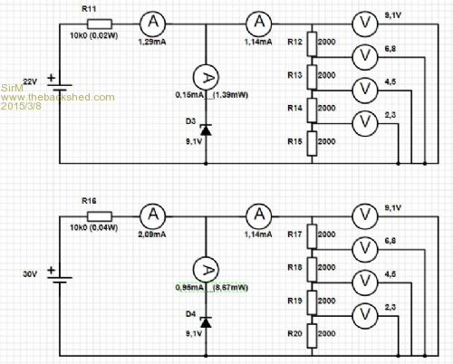

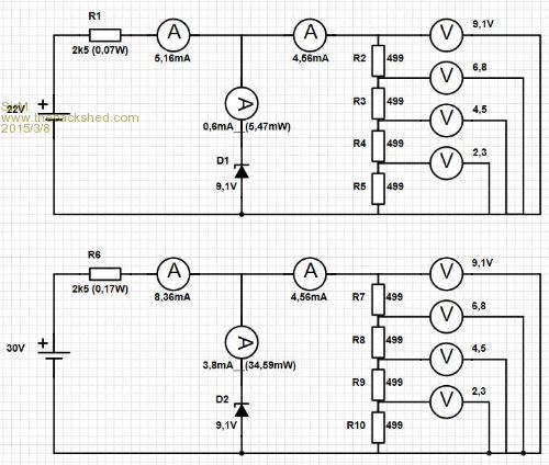

Wonder if I´ve got it right this time...
/ J
redrok
Joined: 15/09/2014
Posts: 209
Posted: 05:25am 08 Mar 2015
Hi Sir_M;
  Sir_M said
Wonder if I've got it right this time...
Yes, you have it right.
I might suggest you change the 2.5K to 2.4K because 2.4K is a standard 5% value.
The PLC I use supplies a regulated 24VDC output. Mine also has a 0V to 10V analog input.
The input impedance of mine is 1M ohm so has little loading effect on the divider circuit. Presumably yours is also 1M ohm.
If you have a regulated 24V output, as mine has, you may want to try:
R1 = 5.6K and R2...R5 = 1K and eliminate the zener diode.
This would then have taps at 0V, 2.5V, 5V, 7.5V, and 10V. (Within the 5% error of course.)
Or
R1 = 1.4K and R2...R5 = 499 and eliminate the zener diode. (assuming you have the 499 ohm 1% resistors.)
redrok
Edited by redrok 2015-03-09
