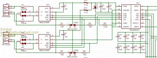

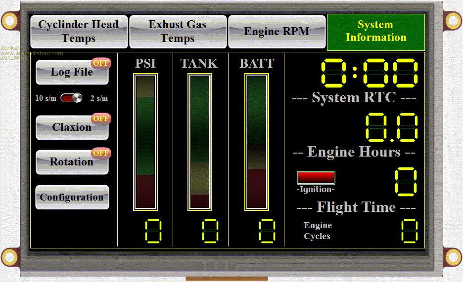

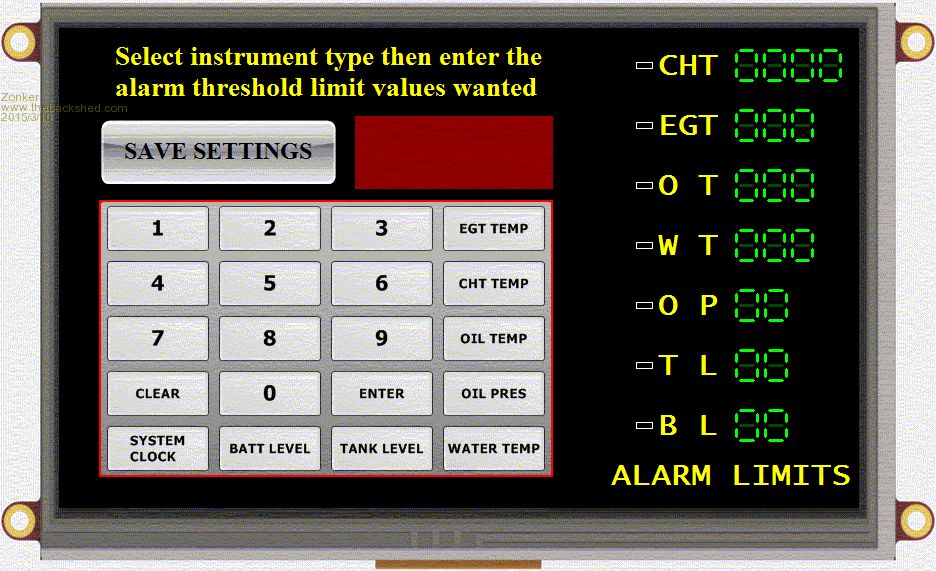

I too are trying to put together an EIS system for ultralight's and LSA's... Like yourself, I wanted to add a Bluetooth transceiver to the sensor input module. I don't know what kinds of BT radio modules are the easiest to use when it comes to the MM's... I setup the system to use power and Rs-485 type wiring inside the plane, but was talked into adding the BT radio in the system also... The displys wanted is pilot's choice... I have done some early work on the color Maximite with the VGA display showing home made bar graphs of the EGT-CHT and other stuff.. 3 thresholds could be set in the standard 4 scale colors (white, green, yellow and red)... A setup file was kept on the SD card as well as the "CSV" based log files... If the user wants to just use a small VGA display and custom KBD, that all a small user would need to keep the price tag low.. Now may buddy Ed, (with the 3-D printer) is creating "old school" gauge cases which we can drive with MicroMite MPU's doing PWM to micro servos doing the needle work. The other display device is a 7" touch panel from 4D systems. This display is the most complicated so far as it has its own setup and logging system built in. It is also going to tie into the plane's COM system for different kinds of klaxon and MSG sounds...
I am currently working on the alarm setup screen for the display and will probably use the 470 Core MM to act as the display controller.
I need to spend more time with the input module as I have tried several type of thermo probe "front ends" to use... I have used the MCP31855 with success, but wanted to do the 8 channels for a cheaper price, as that system requires isolation circuits for the "Hot End" of the CHT thermo sensors.
I have started to take a look at a new IC thermo subsystem from Linear Tech. The LTC 2983 looks like a lower cost way to get the needed inputs. I was in contact with the manufacturer reps and they say ground referenced CHT's can use a differential type channel input setup, so isolation circuits like the above could be avoided.. I will be investing in this subsystem to see if I can get it working ok...
