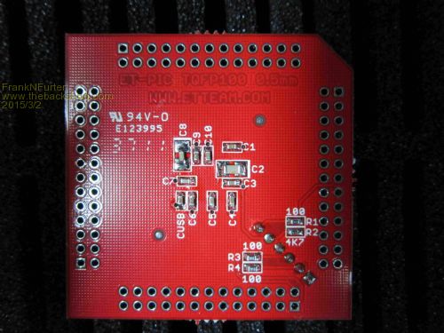

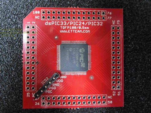

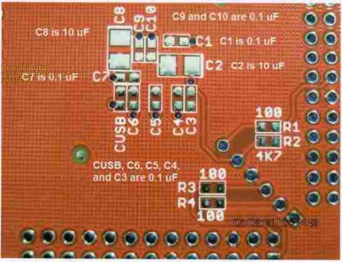

here is my problem child!
I can't find any mistake - I didn't use the John's Raspberry software (not yet - no time )
I soldered 50R on R3 and R4 (PGC/PGD on 26 and 27). C8 is the VCAP and is the same capacitor as on my 32MX170 (which works with this PIC very well)
I measured a resistance between all pin's in megaohms!? All solder joints are looking good under my microscope...
Original AND clone PK3 doesn't find the chip...
Many thanks to all for the help!
...but what's going on???

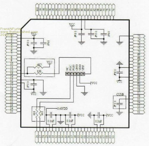

Compare the connections with the Colour Maximite circuit diagram.
I would expect pins 2, 16, 37, 46, 62, 86, AVDD (30) and VUSB (55) to all be connected to VDD. Pins 15,31 36, 45, 65, 75 all to GND.
The chip definitely won't run or program with AVDD unconnected (I've proved this!)
Edited by matherp 2015-03-03

I used one of these exact same BoB PCBs for my first homebrew MaxiMites. From memory, I had to make some (if not all) the power connections on the 'external' PCB that I plugged this module into. Looking at your photo's; how are you applying power to the MPU pins??
I now use different BoBs which have all the MPU's power pins connected to save having to do this 'externally'.
And as MatherP says, ensure AVDD is connected too as these are not connected to anything on the BoB.

Frank
You have got R1 and R2 in place and the correct values?

Posted: 03:30am 02 Mar 2015
Peter,
you are my hero!!!
What a stupid mistake! R1 was a 4k7 instead 100R!
Now I can flash the device without any error with power from my PicKit!
Many thanks to all for your help!!!
