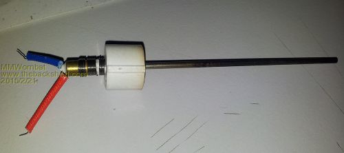

Hi All,
I was wondering if a Micromite would work with a thermocouple sensor, or would I need to amplify the output of the thermocouple with a transistor.
I think the maximum voltage the thermocouple generates is around 14 mV at its highest temperature.
Got one leftover from a soldering iron, that I killed the ceramic heater in.
I wanted to use it to sense the temperature in my 3D printers print head and output the temperature to 3, 7 segment leds.

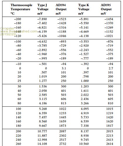

I use AD595 thermocouple amp chips available from eBay for about five bucks each.
What's good about these chips, is that they just output a precision voltage proportional to the temperature of the thermocouple, so you can read that with any analog pin as a voltage. There is no need to translate anything in code, you just read an analog voltage reference for your temperature - dead easy.
EDIT: Here is the voltage output chart from the PDF:
Edited by Grogster 2015-02-21

MM_Wombat
Joined: 12/12/2011
Posts: 139
Posted: 10:21pm 20 Feb 2015
how do I know which type I have?
It has red and blue sheaths over the wires coming out the back.
Which according to the chart at the bottom of this WEBSITE means I have Type T, I assume.
MM_Wombat
Maximite, ColourMaximite, MM+
Posted: 10:46pm 20 Feb 2015
You don't.
USUALLY the blue wire is the COLD JUNCTION, and the red wire is the HOT JUNCTION.
That does not tell you what type it is though. I've never used T-type thermocouples, so not sure what their spec is.
It is most likely to be a K-type, as these are the most common.
If you have a milli-volt meter, put it across the thermocouple at a known stable temperature, then look for a match on the voltage-vs-temperature charts.
It's difficult to be sure what is going on, without a datasheet.
