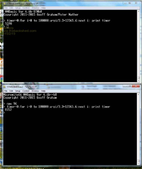

Before putting in any more effort I though I'd try and run a simple benchmark to test the comparable performance - results below.
Basically the performance appears to scale pretty much 1:1 with the relative clock speeds. Comments?
If its not clear on the picture the times are:
ARM@168Mhz 5598
470@96Mhz 8712
170@48MHz 13626
Edited by matherp 2015-02-20
