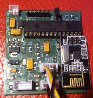

I have built a wireless measurement system with 4 transmitters and 1 receiving center (433MHz or 2.4GHz). It works for months with PIC150MX128B without problems, but since I upgraded to PIC170MX256B following problems have occurred.
1.)
If I Change the batteries in the transmitters at 3 times will exchange, minimum 1 times the Basic program is deleted. The pins console TX / RX are not wired, they are open. With and without capacitor connected to pin 1, the problem persists. (During batteries replacement, the CPU is in sleep mode)
2.)
In the receiving center, the COM1 of Micromite 1 is connected to the console of Micromite 2. Upon loss of power supply, loses Micromite 2 almost always the program, Micromite 1 also, but less frequently.
I have replaced the chips, but the same problem.

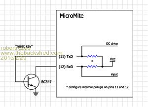

an alternative? if one is indeed needed: how about a 'key' that has to be plugged into the console connection. perhaps an inverter between TxD and RxD pins? this would requite just 1 transistor and maybe a base resistor. configure the internal pullup on RxD as the collector resistor. the onboard current limiting on the TxD pin may be adequate to eliminate the need for a base resistor. if TxD could be configured as an analog input, it would also be possible to measure the transistor's Vbe as an extra level-2 check.
and here's an absolutely foolproof, albeit bizarre solution - require a DS18B20 to be plugged into the console to achieve a reset. connect TxD to the sensor's Vcc pin, RxD to the data pin. one could even require the user to touch their finger to the sensor before performing a reset, to prove they are actually human, and not a robot!
