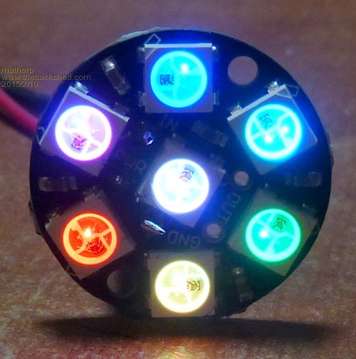

I received one of these in the post today:
So I was able to properly test the code for sending out the pulse sequences and convert it into G8JCF-approved library format (I hope )
I was going to upload a video to YouTube but my camera found it completely impossible to video the display so a static picture must suffice.
The attached code contains a simple example that fades in and out the colours and rotates them around the ring - I wish I had some artistic flair but that will have to do as an example!
The code should be able to handle any number of WS2812 LEDs in the string - power supply and cost will be the limiting factors.
The Cfunction code is included as comments. Remember to get rid of BB created spaces before running - I think they are only in the P40$ and P28$ strings.
The WS2812.init routine sets the CPU speed to 48, the Cfunction will only operate correctly at this speed.
Enjoy

Did you get the code working for the 30 LED string?
I've checked it on the oscilloscope and it certainly seems to send the correct signals.
These is one very strange thing about these devices. With a normal shift register such as the 74HC595, the last bit sent ends up in the first device in the chain so if I have three chained together and I send 3 bytes of information the first byte sent loads into the third device.
The WS2812 is completely the opposite. The first device in the chain "captures" the first three bytes (24-bit colour word). No matter how many more bytes I send this first WS2812 will load the first colour word sent when the load pulse occurs. This continues down the chain.
This does mean that you can send any number of colour words to a chain and depending on the length of the chain, say N leds, it will always be colour words 1 to N that are used, the remainder just clock out of the last WS2812 in the chain.Edited by matherp 2015-02-14

I haven't actually tried it with the 30 string, but its behaviour seems to indicate that it should work.
The C Function bit is OK, it was just the "Example " part of the program that you had tuned to your 7 LED board that needed modification.
I'll see if I can check it before the weekend is over.

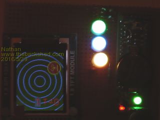

Nathan
Joined: 10/01/2016
Posts: 49
Posted: 11:49am 29 May 2016
I have a APA102 indicator LED on the CPU board and
use some PL9823 8mm and 5mm LEDs, they are WS2812s
compatible. The timing is a little bit different.
The control of the APA102 is easy and very stable.
For the WS2812 the timing ix a little bit tricky.
I have both LED types on the same SPI channel. They are
controlled by two 2 to 1 multiplexer, which build up the
chip select and also makes the 3.3V to 5V transistion.
I personally like the APA102 very much, but in some cases
there is no way around the WS2812. It really depends on
your application and of course the price.
