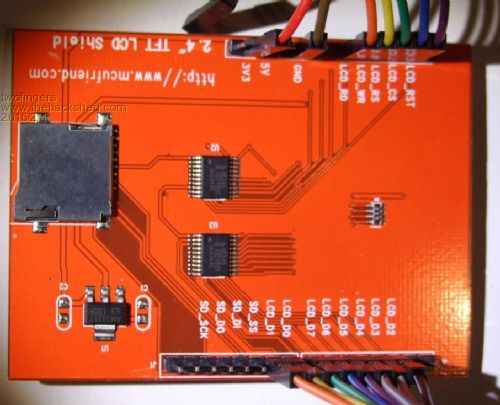

twofingers
Joined: 02/06/2014
Posts: 1782
Posted: 05:42am 04 Feb 2015
WOW, that's fast! Faster than I can boot up my PC!
Very appreciated!
I need only 11 connections to the MM? D0-D7,WR=9, RS=10, Reset
and VCC+GND + RD to VCC, CS to GND
