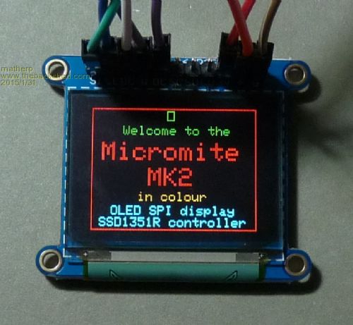

Another by request - this time from WhiteWizzard
This a nice little colour display, runs on SPI, but OLED rather than TFT. It is available in 128x96 and 128x128 versions but there aren't yet pre-packaged ones available very cheap - this one is an Adafruit one purchased from Maplin in the UK.
It needed slightly different Cfunctions from the TFT displays but not too hard to port.
Because it is relatively low resolution it refreshes very fast even over SPI.
2015-01-31_183725_SSD1351ser.zip
The Basic demo/test program and the Cfunction c-source file are included in the ZIP
WW, please note the position of the connection wires. There are two command/data pins (one for the onboard SD card) and it isn't obvious which is which.
The connection to the 3VO pin isn't needed (3rd from right). This is actually an output from the onboard regulator, just connect 3.3V to Vin.Edited by matherp 2015-02-01
Posted: 01:54pm 31 Jan 2015
Another fantastic piece of code (or at least I guess so!).
I was just about to load the code on my module only to realise the header pins aren't pre-soldered (I am away from home and don't have a soldering iron available just now).
Many thanks once again, and also for the heads-up regarding the connections. Will post again once I have the module loaded . . .

You don't need the 64-pin for this small display - it runs plenty fast on the normal Mk2. It isn't the easiest display to build a board for as it needs 12V generating to drive the OLED. The Adafruit Board has a charge pump circuit to get 12V from 3.3
Peter
