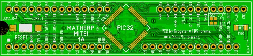

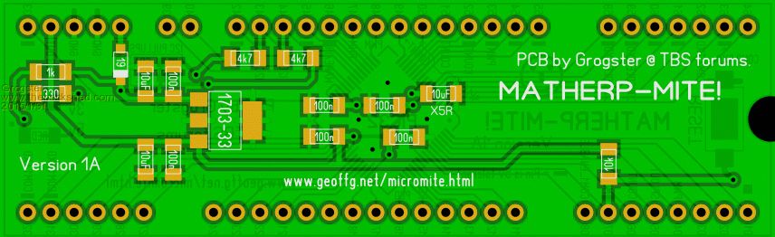

Current version of this board is like this:
TOP COPPER:
BOTTOM COPPER:
I have not yet added the header that WW wants - that's next, but this will give everyone an idea as to where we are at.

Posted: 12:52am 31 Jan 2015
G,
Only observation now is to recommend two different colour LEDs!
For green use GRN on silkscreen, for yellow use YEL, etc (just so it fits in the footprint as you currently have it!)
If going for the SKINNY pcb option then I would recommend 2mm PCB thickness (personal experience with customers breaking 1.6mm boards even with headers along edges). Other strengthening method is to ue extra thick copper!
WWEdited by WhiteWizzard 2015-02-01
Posted: 01:51am 31 Jan 2015
Why would you use different colour LED's?
Does not bother me, but I am curious.....
On the PCB thickness, I always opt for 1.6mm boards, which are USUALLY tough enough.
2mm board can be done, but it is pretty expensive to add that extra 0.4mm....
I am looking very seriously at the skinny option put forward by Mick. It will give me a chance to play again with multi-layer PCB design. If I find it too difficult, we always have the two-layer design to go back on.

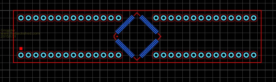

Anyhoo, here is my preliminary SKINNY footprint:
This is also on a 2.54mm grid, but is only 12.7mm between the header pins.
This PCB WILL be 4-layer at least.

Skinny is proving a challenge, but I like "Forcing" a PCB layout to work.
Posted: 02:41am 31 Jan 2015
Is it a 'challenge' due to available space? Or unfamiliarity of using your PCB app with a 4-layer design?
You have me curious now!
Please don't go smaller than 0805 SMDs!!
Posted: 03:01am 31 Jan 2015
Available space.
I've done a couple of practise 4-layer boards, but this one is a real squeeze.
EDIT: - Here is the Skinny version so far. Still more work to do, but it is coming along....
Edited by Grogster 2015-02-01

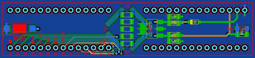

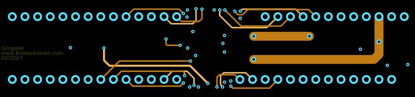

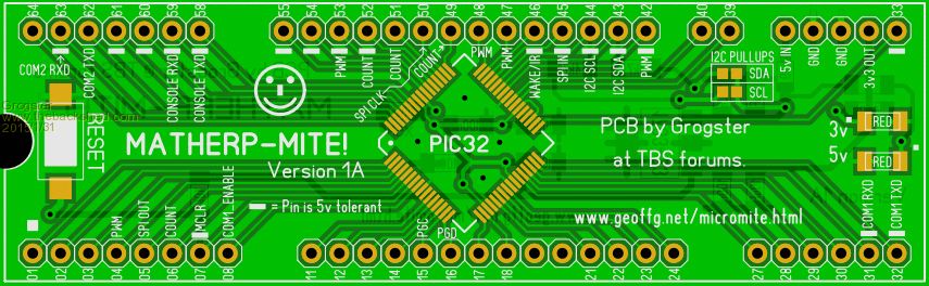

Funny you should mention supervisory chips, TZA - the new board has one.
Here is the current version. 12.7mm row spacing, entire thing is now skinny. 4 Layer board. I will be getting some of these skinny ones made, if anyone is interested. Deliberate offset rows top and bottom on top-right of board, to prevent accidental reverse insertion in a PCB.
TOP COPPER:
INNER LAYERS:
BOTTOM COPPER:
Mick was right - it could be squeezed.
No room for WW's header though, but I don't really see that as a problem - programming connections, 3v3, GND and MCLR are all easily plugged into for initial HEX programming, and then you'd use the console.
Posts: 12071
Posted: 11:22pm 31 Jan 2015
Please change the name - my efforts are trivial compared to Geoff!
Please put me down for a 5.
Can you include the port B pinout on the silkscreen?
Pins on the 64-pin chip are:
16,15,14,13,12,11,17,18,21,22,23,24,27,28,29,30
in that order (portb0..15)
I really like the skinny format
Peter
Posted: 11:32pm 31 Jan 2015
It was your idea - suggest a name, and I will change it.
I will label the port B pins, and upload another image tomorrow.

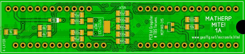

Posted: 03:27am 01 Feb 2015
I would rotate the voltage regulator so that its biggest connection is not right under the PIC.
Normally with 4 layers you have TOP, GND, VCC, BOTTOM. That will help a lot with crosstalk or EMC. De GND and VCC layers are often copper fills only leaving space for the signals to go from top to bottom (vias).
Something to consider when signal speeds are getting higher as with this chip. 80 Mhz is very fast.

Posted: 01:26pm 01 Feb 2015
@ TZA - I have added ground-planes to both inner layers, so that they are also copper-fill/pour where there are not tracks. All four ground-planes on all four layers, are now connected to GND. This means there is an almost full ground-plane right below the IC(inner1), and another one below that. That should suffice, yes? The only thing I see here as a possible issue, is that these ground-planes will have some capacitive effect(in that the layers themselves will form a capacitor within the PCB itself), but as all these layers are at ground potential, any capacitance should be effectively zero. Hopefully.
@ WW - I will be ordering today, after I change the name(as per matherp's request) and add the legend for the 16-bit port he wanted. ETA from factory to me is about two weeks normally, then airmail to you, probably another week. Good things often take time... (and no - I have not forgotten Skype. I hope to get a phone today.)

Posted: 09:34pm 01 Feb 2015
@Grogster:
Your design is on the right way with 4 ground planes! Spent so much vias you can place to connect these four planes together and let no unconnected isles stay around!
(the best is to create fences with vias around the whole pcb to minimize EMI)
Don't use thermal pads for GND-pins! - it's very bad to solder without them but it's better for a lower EMI!
