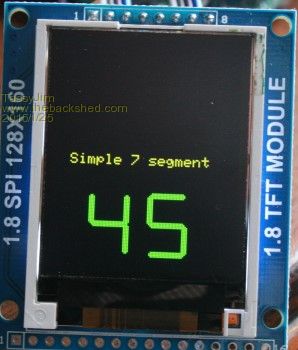

This is a basic way of printing 7 segment style numbers using 'draw filled rectangle' from Peter's TFT code.
It has 3 sizes. This image is size '2'
Each digit takes between 18 and 44 mS to draw, depending on the number of segments.
Replace the T18_test sub with:

Decimal points should be easy to add if required.
Zonker
Joined: 18/08/2012
Posts: 772
Posted: 11:25am 01 Feb 2015
Sweet add-on Tassy..!
Maybe decimal points, the degree symbol and a colon thingy would be good...
I just got in the 1.8" displays and got one going last night... Maybe if I can get more time this week, I can get this working ok...
Looks good on the Display..!
Posts: 6631
Posted: 12:55pm 01 Feb 2015
Decimal points and the colon are simply filled circles.
Degree is an unfilled circle.
New numbers will likely over-write the DP so it would have to be re entered after each write.
To keep you going, here is an update that has size zero numbers.
