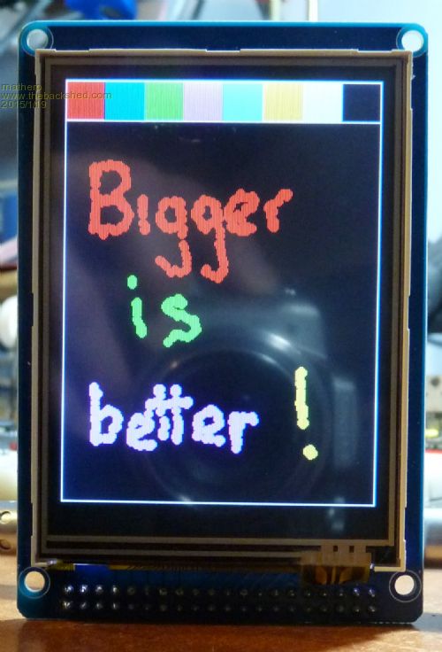

I've attached the same three programs as for the ILI9341 SPI display:
2015-01-19_215112_SSD1289.zip
T32bas.bas does a complete demo and test of the graphics and text drawing routines.
T32calibrate.bas uses the graphics routines and the touch routines and displays the coordinates wherever the screen is touched. This allows you to note down the maximum and minimum coordinates of the display screen for use in calibrating touch applications. In my case the Y coordinates run backwards (On the ILI9341 display it was the X).
T32touchdemo.bas is a demo painting program using the touch input and graphics routines. Touching just below the drawing area on the left side clears the screen. Touching one of the colour blocks at the top of the screen changes drawing colour. The coordinates from the calibrate routine are used to define the xmin, xmax, ymin and ymax parameters. The software scales the touch position to the screen coordinates to draw the trace including reversing the sense of the raw y-coordinate.

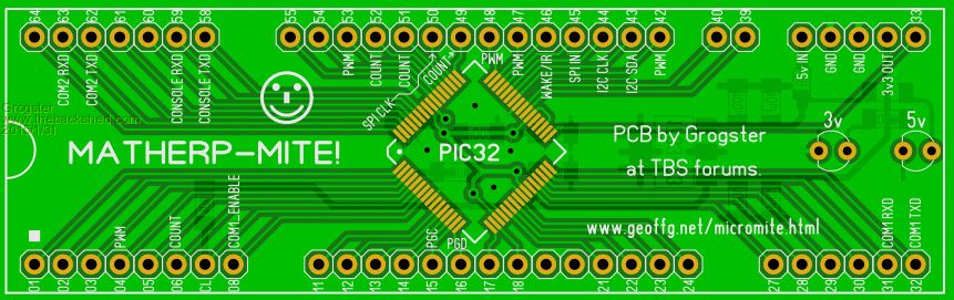

I am about to design a PCB for this module, coupled to the 44-pin uM chip, seduced mainly by the video that matherp linked to in post #4.
The TFT module would mount directly onto a uM carrier PCB, with the idea being that a generic controller code could be designed so that commands sent via I2C or serial, could then control the screen, and feedback from the TFT could be processed and sent back by way of I2C or serial. The uM essentially becomes a glorified screen and touch controller, and that would be it's main task.
I favour serial, just cos of the fact that there are RXD and TXD buffers by default - can't remember if there are such buffers with I2C. Also, using COM1, we could have VERY fast serial control commands and touch responses if we ran at 230k baud.(not that this is really needed, as the 44-pin uM would do all the hard work, really.)
Is this a PCB that people would want?
I have ordered a couple of those TFT panels linked to by matherp in post #1, but I am still having a bit of trouble trying to decipher the code to drive the screen.
God bless matherp's Cfunctions - he the master(and da man!) with these screen driving routines.....
