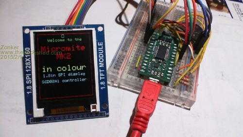

Posted: 06:45pm 23 Jan 2015
Oh joy! Oh happiness!
My 1.8in modules use the S6D02A1
I have replaced the T18.init sub with

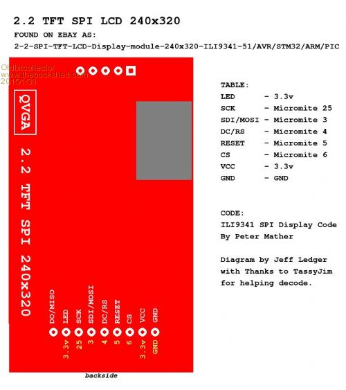

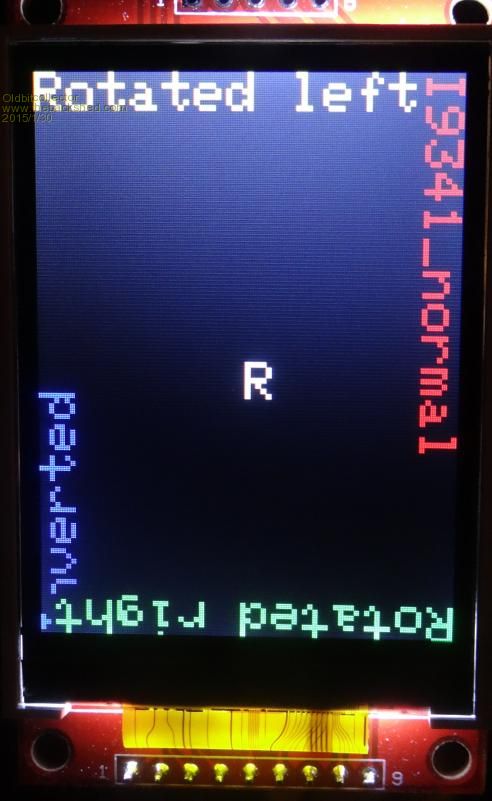

Reporting another success... (thanks to TassyJim for helping me decode it a bit)
I took a chance on the 2.2 SPI TFT LCD-240x320-ILI9341
After seeing it work perfectly here, I took a few minutes to create a simple diagram to help others. See attached
My Propeller/Micromite mini-computer project.

Thanks TassyJim..!!
Looks like the 10 1.8" displays I got were the S6D02A1 type controllers, got the 1st one up and working... Big thanks to you and Matherp for doing the hard work..!
