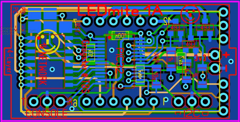

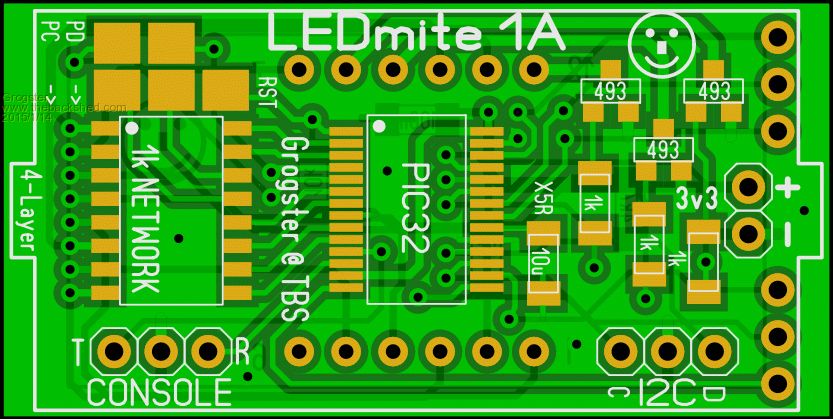

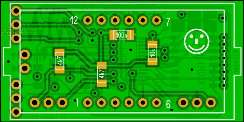

This is a full MicroMite MK.II on the back of a three-digit LED display. All the interfacing to the LED display is on-board, as are the console, I2C, PICkit3 programming pads, COM1 serial port, and a few other I/O pins that I could squeeze in.
Designed specifically to fit into those cheap LED panel displays you can buy on eBay for about $2.50 each. You pull the existing module out of the panel bezel, and fit this as a replacement - it just pops in where the original unit was.
The PCB is 41mm x 21mm, and is a 4-layer board.

Top Visible Layer:
Bottom Visible Layer:
All Layers:

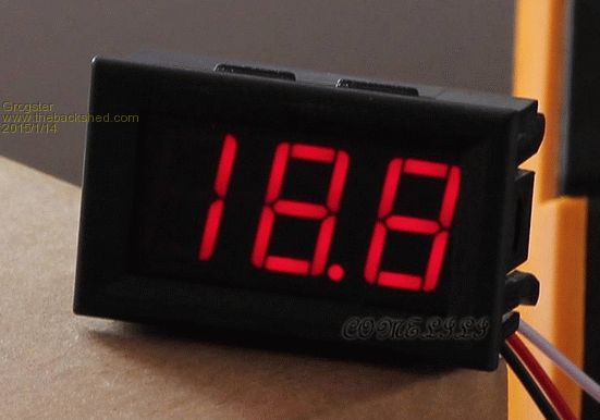

Image stolen from eBay of how display looks from the front:
This last image, is a mock-up, and not the actual unit, but this is what it will look like when finished.

Can you please confirm if this is a 3-digit counter or a two-and-a-half digit counter (as implied by the picture).

As to the counter, it can be whatever you need it to be, by changing the code in the PIC32. Originally, I wanted a three-digit display as a temperature meter, so that I could display the output from the likes of an 18B20.
I know you can get ready-made temperature meters all ready to go from eBay, but there was a issue in that I needed to monitor two or three different temperatures, so I can do that with the MM-based display, by cycling through the temperatures on the one single display. There are external LED's to indicate which temp is currently showing.
