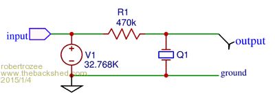

i wanted to look at ways to use a micromite to measure the frequency of a 32kHz watch crystal, using the minimum number of components. if the micromite can measure the crystal frequency, the result will provide a correction factor for the onboard RC oscillator and allow improved timing. it will not be perfect, but for many applications will be ok.
the circuit i simulated is this simple one:

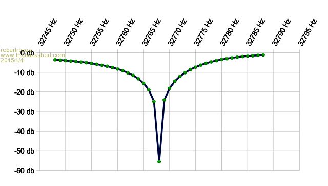

with the following, quite pleasing, results:
this suggests that if one were to feed one of the PWM outputs to the input, scanning over the range of 32768Hz +/- 1%, it should be possible to detect at the output (using a second pin) the two (fairly symmetrical) edges shown of the graph. even if just using a digital input, the interval is likely to be a few dozen Hz wide - the target frequency will be the average of the two detected edge points.

Perhaps use the counting command over a couple of seconds and do an average from the returned value?
Or generate a Cfunction [which is faster and probably more accurate]
