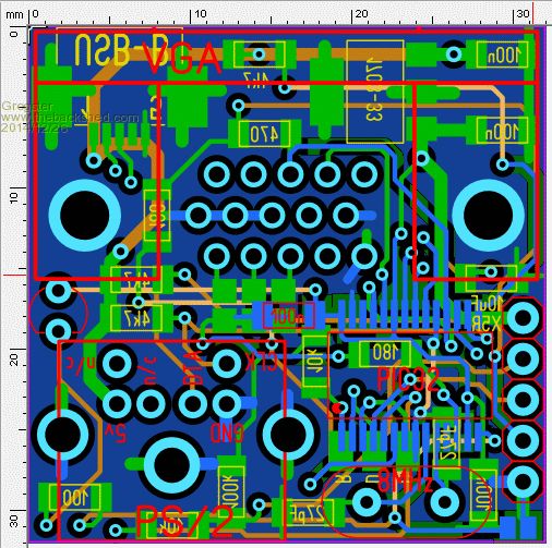

Hi folks.

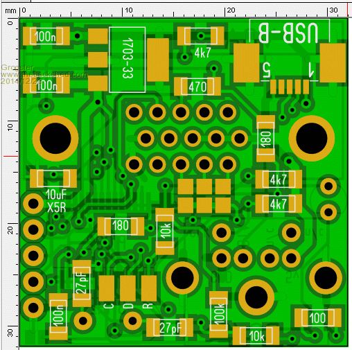

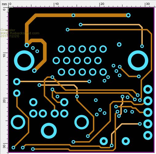

Playing around with multi-layer board designs now, and this one is four-layer.
This board is only 32mm square, but contains the full VT100, including on-board VGA socket, PS/2 socket for the keyboard, USB connector, 3v3 regulator, activity LED, colour select pads, composite video out, regulated 3v3 out, RXD input protection resistors and three pads to allow you to program the firmware into the chip in the first place. These are just solder pads, cos once you have the firmware in there, any updates can be via USB, so you should only ever need to do this once in an ideal world. Power for this module is via the USB cable. There is no provision for external power, but with the plethora of cheap USB charger plug-packs that can be had(often fitted with a USB A type socket), one of these and a USB cable and you have your "External" power.
TOP (visual layer only):
BOTTOM (visual layer only):
INNER LAYERS:
ALL LAYERS:
Pin header at lower-right side of board allows for various connections and is 3v3, RXD, TXD, VIDEO OUT, GND - top to bottom.

I did not really NEED a VT100 this small, it was just an excuse for me to play with multi-layer. And Shenzhen's PCB prices are just too good for me to not have a play with multi-layer - US$22.90 for ten of these four-layer boards.
Having set the PCB size, the mission was "Can I squeeze it all in there?"
You would have no hope of doing this module, this small, without going multilayer, I would think.(prove me wrong though!)
The PCB size came about based on the VGA socket footprint. It was 31mm wide, so add 1mm and make it square - that was how I came up with the 32mm square size.Edited by Grogster 2014-12-27

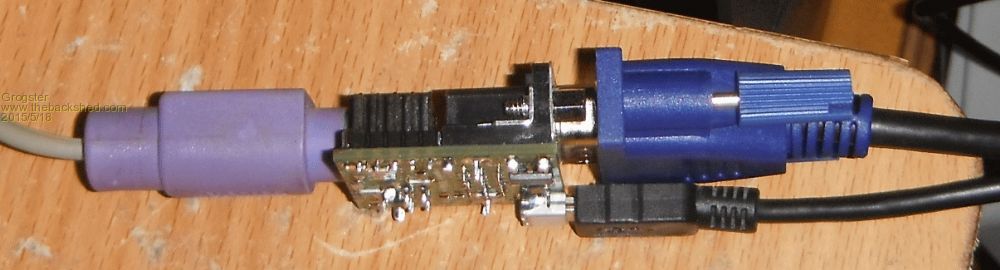

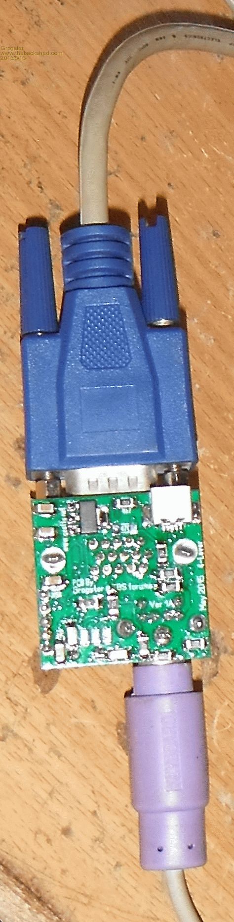

UPDATE: Well, I have assembled one - the VGA and KB plugs show how small this board is.
One thing I did find was that having the VGA on one side, and the USB on the other, the bodies of the plugs hit each other - I actually expected that. I will fix that problem by sanding down one side of a mini-USB patch lead for use with this board. These leads are a dime a dozen.

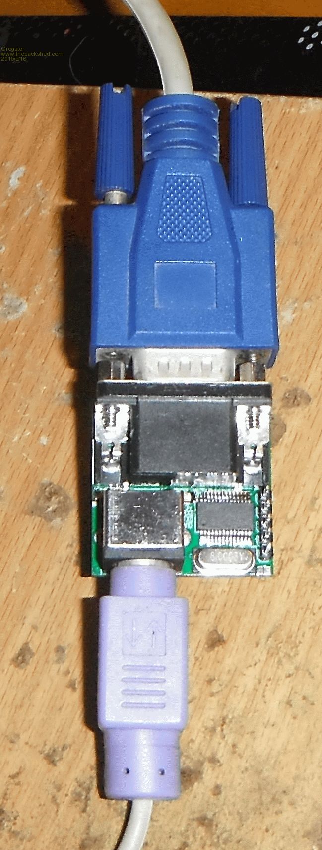

UPDATE: It's a squeeze plug-wise, but all up and running with VT100 firmware 1.3
You CAN'T get away with the bulky VGA plugs, but the thinner VGA patch cables that are all over the place have thinner(cheaper!) cable and thinner moulded plugs, so they fit fine.

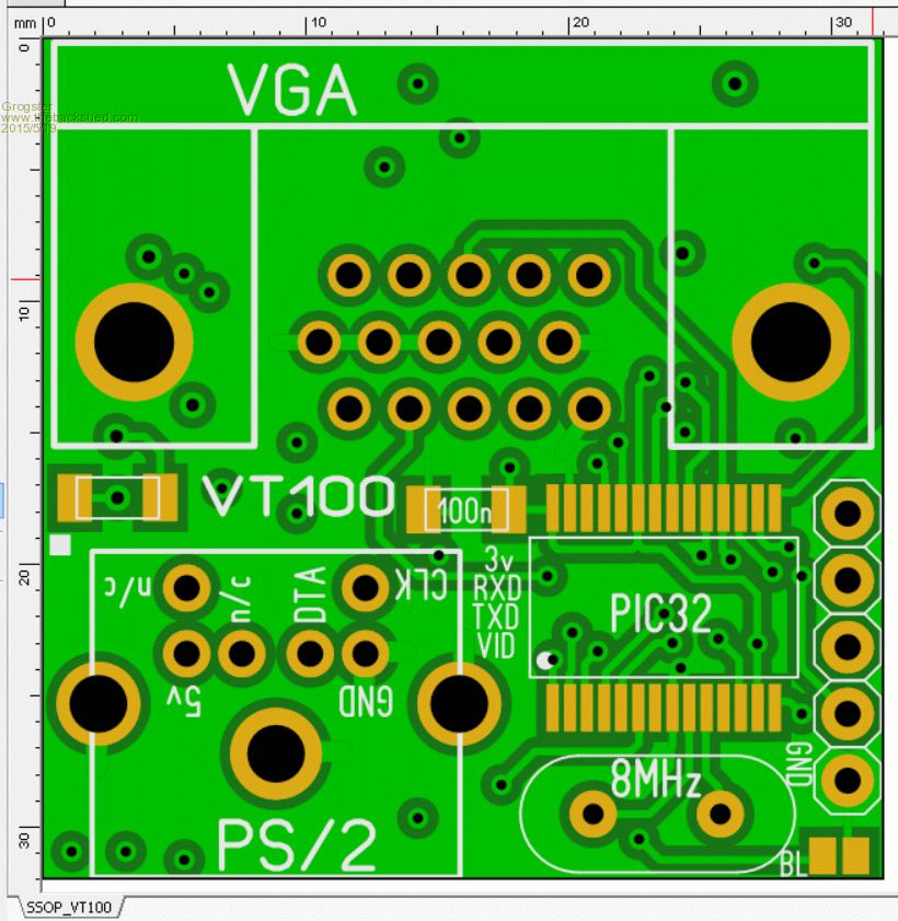

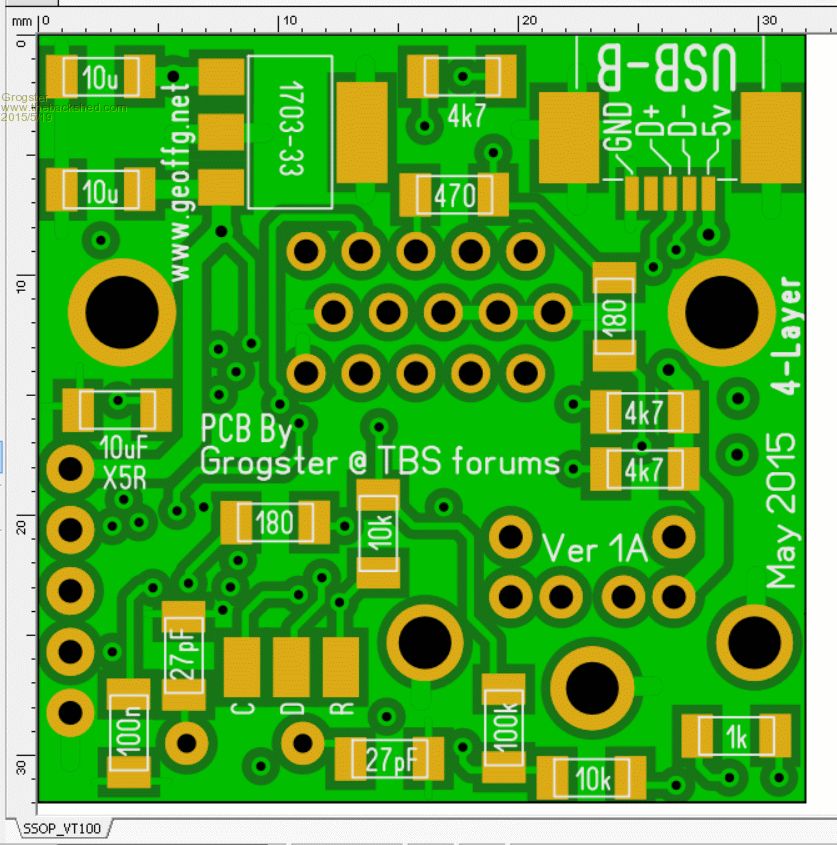

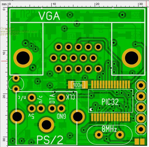

For those making the unit, here are some updated GIF images of the top and bottom for assembly purposes:
TOP:
BOTTOM:
That should make life easier for those assembling the boards.
All parts are standard 1206, regulator is MCP1703-33.
USB socket is Element-14 part 2300434. The circuit is Geoff's VT100 except that I used a different regulator. The final version is green video only - I got rid of the colour-select pads. Green really is easiest on the eyes out of RGB! 3mm LED changed to 1206 SMD LED. 100n caps on regulator changed to 10uF - I just used the same X5R ones I use for Vcap, as I had them in stock, but X5R is a good choice for general use too, IMHO.
Note that there are NO baud-rate pads or jumpers. Default baud-rate will be 1200.
You use the internal config utility(SHIFT+F12) to set the options you want, so you will need to go in there and set the baud-rate.
Initial programming of the firmware into the virgin PIC32 requires a LITTLE fuffing around. You tap into 3v3 and GND on the pin-header, and you need to tack-solder three thin wires to the bottom solder-pads labelled (C)lock, (D)ata and (R)eset.
This gives you the five wire interface to the PICKIT3 programmer. So, to make things a little easier:
"R" pad to PK3 pin1(MCLR)
"C" pad to PK3 pin5(PGC)
"D" pad to PK3 pin4(PGD)
3v3 and GND header pins to PK3 pin2 and pin3 respectively.
Once you have the first firmware in there, any future updates are via the USB connection, so this only has to be done ONCE, to get the firmware + bootloader into a virgin chip in the first instance. Naturally, you remove these temporary wires once you have a running firmware in there.
Solder-blob across the two small pads on the top side, just below the pin-header, to select bootloader mode for updates. You should not need to do updates very often(if at all) if you flash in version 1.3(+ bootloader!) when you start.

Grogs, here's a thought for future boards and to see what others think.
I've got a good stock of 0805 resistors but very few 1206's (resistors that is), and I think for many people that's pretty common. I like the idea of using the 1206 pads because they're certainly easier to manually handle but as a compromise to handle both how about extending the 1206 pad design you're using inwards a little bit so that 0805's can be used as well. When I put together my Skinnymite board I used 0805 resistors on the 1206 pads and they came up well, but the connection relied on the solder's surface tension from the pad to the outside ends of the 0805's because there's no overlap. Having them overlap just a bit would help.
The same's maybe true (though a lot less so) for 0805's in the smaller caps, especially the always needed 0.1 uF's. Getting the right value cap in a particular size and at a reasonable price or quantity break, is sometimes an issue. If either size could be used it would make sourcing some of them a bit easier.
I'm definitely not suggesting you should go to 0805's generally unless you need to if you're trying to minimise board space.
Greg
Posted: 10:04pm 18 May 2015
Good idea Greg, will take it under advisement.
