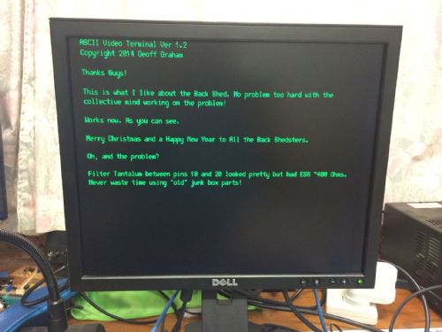

vk2sja

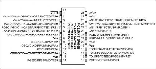

BobD
Joined: 07/12/2011
Posts: 935
Posted: 12:10am 26 Dec 2014
Steve
You sound confused about pins. Have a look at the image or look in the zip for a bigger picture. It is from the Microchip datasheet.
2014-12-26_100904_PIC32150F128B.zip
Bob

Joined: 07/06/2013
Posts: 26
Posted: 12:26am 26 Dec 2014
Hi Bob,
Thanks. I've got the data sheet pinouts. Been looking at them most of the afternoon.
The confusion is that the ASCII terminal board connects ICSP data and clock to pins 2 & 3 (perhaps not in that order). While Mick's uMite has them connected to pins 4 & 5. And I'm being told that the ICSP clock and data are the same for both chips.
But last time I checked 2 != 4 and 3 != 5
So there is something here I don't understand.

BobD
Joined: 07/12/2011
Posts: 935
Posted: 12:51am 26 Dec 2014
Do you have a choice but to trust the data sheets? Diagrams have been known to be wrong before.
BobD
Joined: 07/12/2011
Posts: 935
Posted: 01:03am 26 Dec 2014
The pinouts for the 150F and the 250F are different.
The 250F has the following
PGED1=4
PGEC1=5
PGED2=21
PGEC2=22
PGED3=2
PGEC3=3
The 150F has the following
PGED1=4
PGEC1=5
PGED2=21
PGEC2=22
Posted: 01:33am 26 Dec 2014
Yes, as others are saying - it is only the pinout.
I can see why that would throw you, though.
So, in other words, you CANNOT put a 150 chip in the Silicon Chip PCB you have there and expect it to work, as that board was designed for the 250 chip, and the programming pins especially, are then not where the PICkit3 is expecting them to be if you use a 150 chip.
However, you can design your own PCB around the 150(or just build it up on a breadboard for the purposes of testing) and that works, from all the information I have read.
Posted: 01:34am 26 Dec 2014
bob just beat me to it. while an MX150 will work in the terminal PCB, the ICSP connector on the PCB runs to the wrong pins, so you can not upload firmware to the device. in all other regards (apart from USB) it works.
it is allowable to use any of the three pairs of ICSP pins (PGCx and PGDx), but they must be used in pairs. ie, using PGC1 and PGD2 together will not work. your easiest bet is to make up a ZIF socket on a scrap of veroboard containing the ICSP socket (wired as per micromite) and the 10uF capacitor, and use that for programming devices. pairs 1 and 2 are on the same pins on both MX150/170 and MX250/270 devices. this is what i do.
rob :-)

vk2sja
Joined: 07/06/2013
Posts: 26
Posted: 01:47am 26 Dec 2014
Thanks Bob,
That sums it up succinctly I think. I've been reading:-
http://ww1.microchip.com/downloads/en/DeviceDoc/61129F.pdf
And from what I read it does not matter which PGEx pair you use. So long as you use a matched pair. The ASCII Terminal PCB connects the ICSP clock and data to the PGE3 pair on pins 2 & 3 of a 250F. Which is fine accept when you try and substitute a 150F which has no PGEx pair at all on pins 2 & 3.
I'll mod the PCB to move the ICSP data & clock permanently to pins 4 & 5 -> PGE1. Which should work for both 250F and 150F and also solve the problem of needing to remove the baud rate jumpers prior to programming.
However...
Pin 5 PGEC1 on the ASCII terminal is connected to 3v3 via 100k + 10k resistor chain. As it is being used as the serial RX pin. I don't suppose this is causing me a programming issue? Software didn't error at all. And I would have thought being on the other side of 110k would have been alright.
Anyway, things to try tomorrow.

Eureka! As they say.
Big thanks to:-
JohnS, for writing the Raspberry Pi ICSP programming software. Works a treat and I can assure everyone that it is FAST! In my case especially important because I had no other programmer available.
Bigmik, for thoughtfully providing an updated v1.2 firmware image that contains both the Bootloader and Program. Mind you when the MX250F arrives I'll still have to flash it with the Rpi because I have no USB with the MX150F. But at least I have the latest Firmware.
BobD, and all the others who replied. For giving me a quick run-down on 23 bit PIC ICSP programming and pinouts.
And Finally to Geoff, who was able to pin-point the problem to the 10uF Tantalum on pin 20.
And the problem? My 10uF Tantalum capacitor shows an ESR of about 0.5K Ohms in my component tester. Whereas a garden variety 10uF electrolytic was reading about 0.2K Ohms in the same device. So I replaced it with a 1uF (all I had on hand) Tantalum that had ESR so low the tester couldn't even see it (i.e. less than 1 Ohm). As soon as I did this it burst into life.
Wishing everyone a Happy and *Safe* New Year!
Steve.
