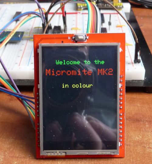

I've updated all the graphics routines with additional cFunctions. The only significant Basic code left is now the filled-triangle routine.
I've also further optimised the 2.4" TFT cFunctions. There is a Youtube video I found of the Arduino writing a 100-pixel radius circle in response to a touch input. The Micromite code appears to run at least 5x as fast doing the same thing.
If you are playing with previous versions of code for any of the supported controllers, please update.
These routines are now finished (he says hopefully ).

1.8" TFT SPI colour, ST7735 controller
2.4" TFT parallel colour, ST7731

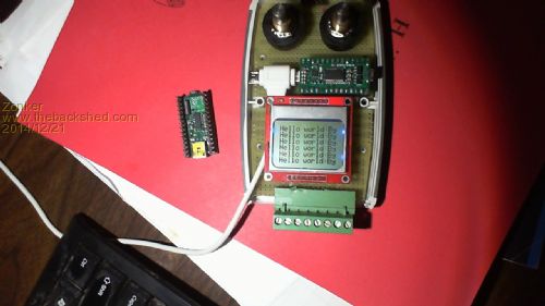

Good evening Peter
I was using you original library posted on 11-30 on my DIP-600-28 prototype board with a Nokia display and managed to get it working ok. I was changing the code around to take out the RTC and temp IC parts intending to replace those parts with the RTC-Fram IC code used on my board. When returning to the forum I noticed you had posted a new library update (awesome work!) so, I thought, after taking a look at it, why not start over and use the new code and start testing again... I modified it to change the display control pin numbers and tried running it...
The display doesn't display anything so I tried doing a "ctrl C" to stop it but could not get back to the command prompt. After a hard reset I turned on the trace (tron) and ran it again. The trace seems to get to line 192 and then just hangs up. The trace seems to point to the LCD.SCmd (send command) subroutine.
SUB LCD.SCmd(Comnd%)
local i
pin(LCD_cd)=0 ' Send this byte as a command
PIN(LCD_cs)=0
i=spi(Comnd%) <<< This is where the code seems to hang up >>> (line 192)
PIN(LCD_cs)=1
END SUB
I am not sure why this is happening... The only things I changed so far are the pin numbers driving the display. I am assuming that "rs" stands for the display RESET line and "cd" stands for the command/data line and the "cs" stands for the chip select or display select line...
I think the hardware is connected up ok since the older library post code was working correctly. I will have more time to fuss with things tomorrow after church... Now it's pillow time... zzz

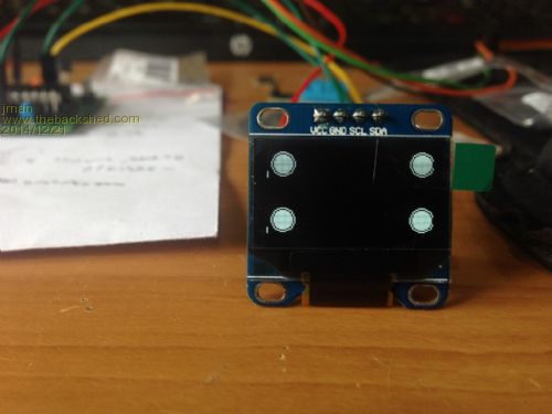

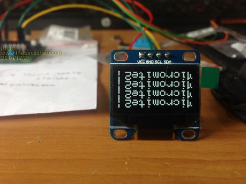

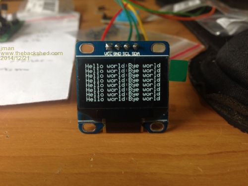

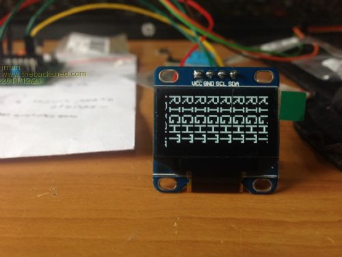

Hi
I have at last hooked my little .96 I2C OLED display (SSD1306 128*64)
The first screen is normal but the rest seem to be shifted to the right
pictures below to show the problem
Jman
Posted: 12:54am 21 Dec 2014
Jman
There is an offset parameter to the init routine. It is probably set to 2 in the example program. This is needed for the 1.3" OLED displays as they seem to be wired differently. Change the offset to 0 and the problem should go away.

Zonker
What version of the firmware are you running? My code for the Nokia was tested on 4.6b27. I haven't retested on 4.6 release and can't now do this until Tuesday but I expect it work work fine. There were problems with SPI pre b27 which Geoff fixed for me that related to the mixed use of the SPI write and x=SPI(y) syntax in the same program.

OK...
I have updated to the new v4.6 firmware and all seems to be good..!
Thanks Pete..!

  matherp said   Jman
Thanks for that worked a treat

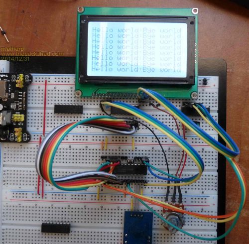

Posted: 10:02am 30 Dec 2014
New file supporting standard KS0108 based GLCD. Note the use of DIL resistor packs to interface the 5V display to the MM
Fixed pin allocation is:

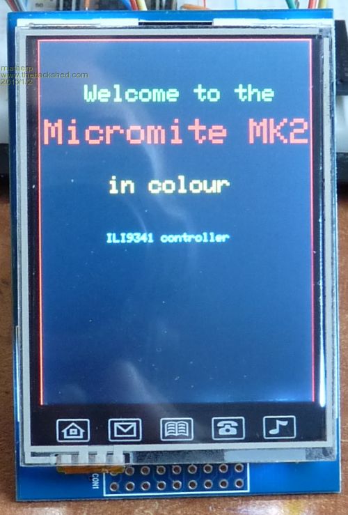

Posted: 10:59pm 01 Jan 2015
There are both 2.4" and 2.8" displays on sale that advertise they use the spfd5408 controller. Based on a sample of two, my 2.8" display and bigmik's 2.4" display, these actually use the ILI9341 or ILI9340 controller. This code works for both. There are also ILI9341 displays advertised but these use an SPI I/F. These are not supported by this version.

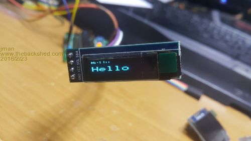

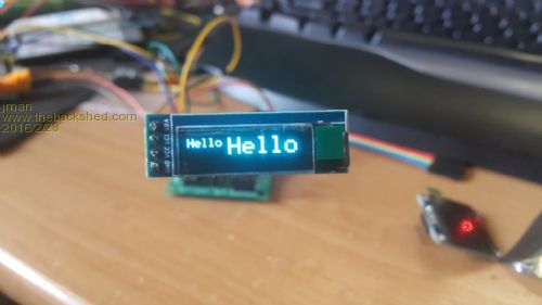

Posted: 10:48pm 22 Feb 2016

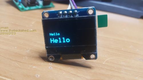

Hi
I wondering if the I2C code could be adapted for this OLED
OLED
It uses a 96x16 OLED with a SSD1306 - I2C controller
This the code I used
OLED.pstring(5, 32, "Hello", 1, 0)
OLED.pstring(5, 48, "Hello", 2, 0)
I have tried and it does work to a degree with font size 1
the display is perfect with font size 0 it is broken up
96x16 OLED
128x64 OLED
Many Thanks
