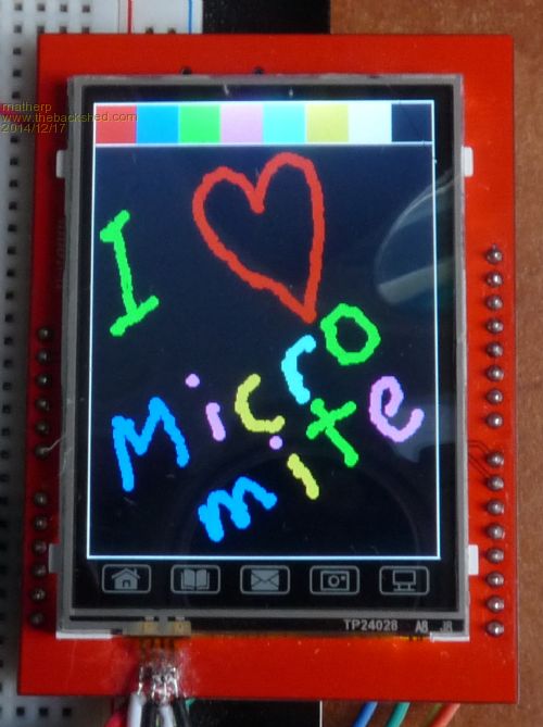

OK so I'm not an artist
This was a bit of a struggle getting to work as I came across a firmware bug in 4.6b26 relating to analogue input modifying the status of other pins. This has been reported to Geoff.
The 2.4" TFT Arduino shield puts the touch input connections onto some of the same pins as are needed for the display. As part of debugging the problem above I disconnected these from the shared pins and connected them directly to the Micromite - you can see the soldered-on connections in the picture.
To understand how to drive directly a resistive touchscreen see the excellent note from NXP
I've also converted an additional routine (fcirch) into a cFunction to speed up filled-circle drawing which I use for drawing the trace.
The code currently polls for a touch but it is easy to set up an interrupt which is triggered by a touch - the statement to do this is identified with a comment in the code.
The Basic code that does the work is pretty simple:

Complete code and updated cFunctions attached:

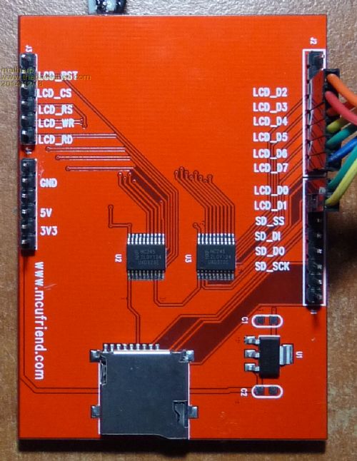

Sorry for chime in here but can anyone send
me 2-3 displays to germany because the seller
Wont sell to germany!
Thx

Sorry I'm also a bit confused and my display arrived today.
Can someone post a schematic (idiots guide) showing the pinouts and connections between this unit and the MM2.

The bottom of the display should be silkscreened as above
connect:
LCD__CS to Micromite Pin 4
LCD__CD to Micromite Pin 5
LCD__WR to Micromite Pin 6
LCD__RD to Micromite Pin 7
LCD__RST to Micromite Pin 14
LCD__D0 to Micromite Pin 17
LCD__D1 to Micromite Pin 18
LCD__D2 to Micromite Pin 21
LCD__D3 to Micromite Pin 22
LCD__D4 to Micromite Pin 23
LCD__D5 to Micromite Pin 24
LCD__D6 to Micromite Pin 25
LCD__D7 to Micromite Pin 26
You also need to connect 5V, 3V3 and GND
The touchscreen code I listed won't work as I have butchered my display to break out the touchscreen pins from the shared pins on the normal board.

Gday Matherp,
connect:
Use this code to get you going:
My display arrived today, it looks identical to your picture above except it has a very small resistor network near the top, center.
Your wiring list states:
But there is no LCD_CD pin labelled. The only LCD_PIN not used in the list above is LCD_RS is this the pin that connects to pin(5)?
If so my display doesnt work with your sample code..
It changes the display to be every second row off (from every row on at power up). The code reports Controller type 0000
My controller chip (as stated by the seller) is supposed to be spfd5408 controller with built in video RAM buffer
Any ideas?
Do I have to cut the touch screen wires away to run the code?
Edited by bigmik 2014-12-30

LCD_RS is the pin to connect to the micromite's LCD_CD input (basically selects between register select and data mode). Sorry the naming in the program didn't get edited from a different display.
Lets try and get the display running first and then tackle the touchscreen.
I've found some different Arduino initialisation code for the SPD5408 rather than the ST7731 and edited it to fit in with my code.
In routine sub T24.initdisplay try replacing lines between the second pause 100 (after the reset) and the final pause 50 with the following:
