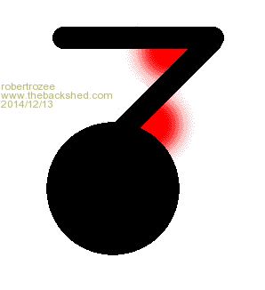

a nice bit of layout. though one thing to be cautious of is sharp corners - the track from the pin labelled "21" to "PGD" is one such example. i've always been told that the inside of corners can present etching problems, as well as traps for etchant. see the below example with 'bad corners' marked in red:
so i try and keep all angles as shallow as possible. in the past i've done this by making corners two turns of 22.5 degrees wherever possible, and if unavoidable 'knocking off' the sharpness with a little bit of track added in.

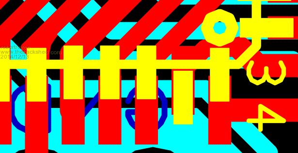

addendum: just spotted, you have a short between pins 42 and 43, and the routing of pin 33 is unnecessarily complicated. does the package you are using have a 'design rule check' facility?Edited by robert.rozee 2014-12-14

The design is certainly checked and there isn't a short between 42 and 43; what made you suspect that? What looks like a via near pin 44 is just the pin 0 mark on the silk screen.

Posted: 04:47am 13 Dec 2014
it could just be the way acrobat reader is rendering the PDF file, attached is a zoomed-in view of the area as it displays on my PC:

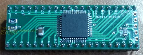

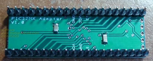

Here is a slight update.
I've got rid of all the smallest vias and changed the VCC/GND pins so there is now one of each in the middle pair of pins on each side. These are arranged such that the chip can be plugged in either way round and the supply will still be correct.
I've attached the gerbers as well as the PDF of the layout.
I'm getting a set made by Itead. If anyone wants one of these or any of my PC designs I suggest you try and twist the arms of bigmik, WhiteWizard or equivalent. The designs are completely available for anyone to use or abuse as they wish.
