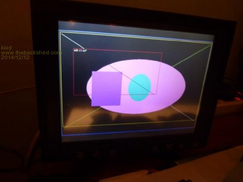

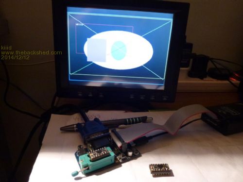

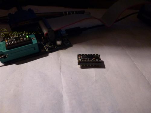

Joining the teasers with mine - a full-blown graphic controller in true DIP16 format (fits into a standard DIP16 socket/footprint). Here are some early pictures with and few random shapes and colours in them.
The control is via SPI and there is a nice set of simple built-in functions for text and graphics. The firmware is now very close to being complete. I will have this on the market soon with price tag around $12 per piece.

The device has 128k of RAM and the graphic mode is fixed (for now) at the standard EGA resolutions of 640x350 x16 colours. Text is EGA as well - 80x43 x16 colours. Text and graphics can be mixed and masked in many different ways. Fonts and sizes are supported as well. There are other nice functions, also supports sound and also a single channel analogue input for applications such as keypad or a slider.
Speed is no worse than a typical EGA controller from that age. It won't run well a modern 3D software engine, but that's not its purpose anyway.

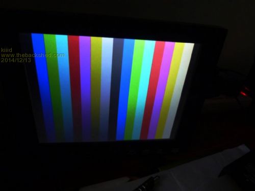

The resolution ultimately comes down to available memory. In 128k it is possible to go up to 640x400 in 16 colours, but as I mentioned there are some other built-in features which require memory, so the native EGA mode seems to be the maximum for now. 640x400 is still an open option though.
The device makes analog drive signals just like VGA, and so far I have not seen a monitor which won't lock to the standard EGA mode. VGA and EGA share the same 25.175MHz pixel clock and VGA monitors are required by specs to work in EGA mode for backward support. Even the newest ones (I tried on a 24" WUXGA and it worked perfectly). The microcontroller is ATSAM4S and when they release a new revision with more memory, then the step from EGA to VGA resolution will be quite easy.
Fitting everything into a single narrow 28-pin socket is a good idea. I hope to see it done someday.
Unfortunately the manual is still not ready. In a few words, it is a very simple command protocol via SPI and I have designed it such way to provide the most functionality in the minimum set of commands so it can be driven by virtually any microcontroller, even the simplest ones. I have particularly considered to make it easy for control from a uMite and small 8-bit microcontrollers so no memory resources are required from their end. Working on the manual so hopefully that will be ready soon.
Here is another picture with the colours on my test monitor. Will keep the forum updated.
