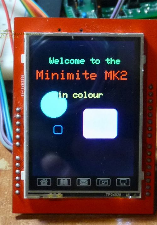

Not fully worked yet but already much faster than Arduino.

Holy Crap! That's exciting!!!! and faster than arduino, even better yet!

Which display is that? I assume touch screen too.

Don't know where I got "Minimite" from duh...
This is the
Display :

That's exciting. Keep up the fantastic work!

Boom! That is fantastic! Can't wait to play with this.

I ordered one as soon as I saw this in anticipation. Great work.

Matherp,
Wow,
I love it and at 1.99 GBP that is less than $4AUD
Crikey..
Will the 3.2" displays work just as well?
What sort of interface are you using?
I assume you use CFunctions.
Sorry for the inrush of questions, I feel excited but this.
