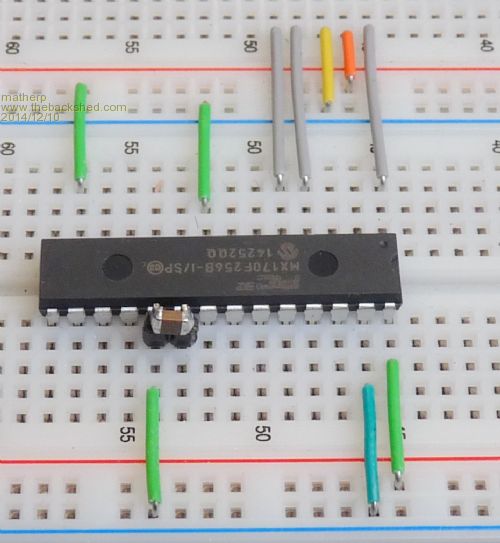

Silly little trick but perhaps useful.
1206 SMD parts solder perfectly to 2 pin headers which makes them ideal to use on breadboards rather than getting the poor connections which thin wires can give.
In particular this is useful for the Vcap capacitor for the PIC32. High value multilayer ceramic capacitors are the best solution for Vcap and as can be seen in the picture, soldering one to a header makes it trivial to use. I use a small crocodile clip to hold the capacitor in place while I solder the first side.

That's a good idea.
I do something similar with a couple of short pins soldered to the cap but yours has the added advantage of mechanical strength of the header pin moulding. My caps are a bit bigger than yours and I have to put them in holes diagonally to fit.

That's nice and neat Peter. They solder neatly across Veroboard track too, as do a lot of SMD parts. I've seen someone on TBS who soldered them direct to the chip pins too, close to the plastic!

If U buy uMite chips from Phil at Micromite.org, he solders a tiny cap across 19 and 20 for you.
The use of pin header is good, I use blue tack to hold the smd cap to a toothpick, the pin header in a wee jeweller's vice, leaving the other hand free for the soldering iron.
