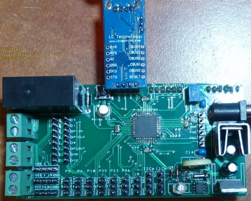

The area marked live,neutral and earth if this is intended to be connected to mains voltage as the names suggest it could be lethal without adequate shielding.
The scl line to the rtc (pcf8563) appears to be on another layer dark blue with no way to get to the top layer which I assume is the red.
The close proximity of the rtc xtal to a heat source (VCC reg)could cause a stability problem.

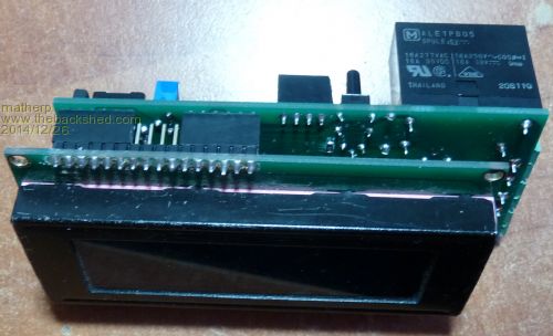

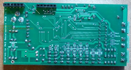

I got the boards back from Itead Studio just before Christmas and got a chance to build one up today. For test purposes I fully populated it. Overall I'm quite pleased with the result. Everything works as it should.
I didn't make any changes from the original circuit but take on board the comments from paceman - good ideas for V2.
centrex: Obviously care must be taken if switching mains. However, the clearances meet normal standards so the critical thing is the housing if used in that way. The dark blue line is just an artifact of that net being highlighted when I took the picture. The VCC reg is only ever used to drop from 5V to 3.3 so heating shouldn't be too much of an issue but I'll look at the layout if I do another version. The VEE reg does the main work and if only 3.3V is required the regulator goes in that place and the VEE-VCC bypass link is installed.
The pictures show both sides of the board and also it in use as an LCD backpack.
