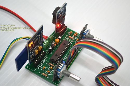

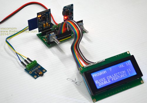

Against all odds, I happen to have a very cool mother in law and for this Christmas I have been working on an "antique radio" for her that is neither antique or a radio. I used a uMite along with an mp3 module, a 3231RTC, 2 rotary encoders, an IR detector (for an apple remote) and a 2004LCD display for the electronics and built a cabinet to put it all in. Here are some pics...

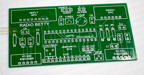

This is the pcb (my very first one) designed in Autotrax Dex and made by Itead.
The board with all its parts.

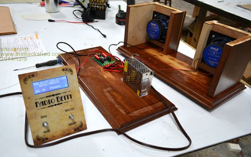

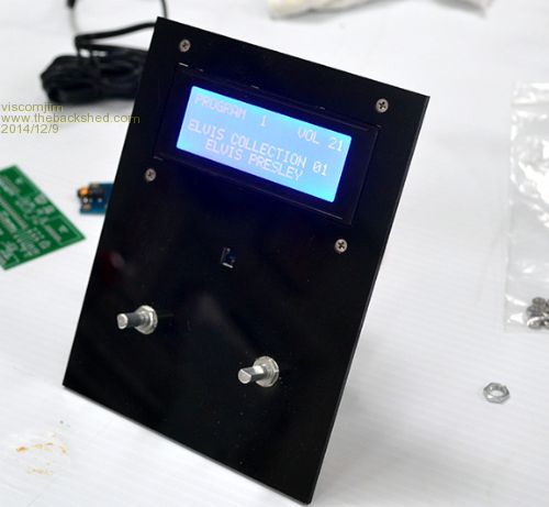

I used a piece of black acrylic to mount the display and board. The square hole below the display is for the TSOP4838 for remote control.

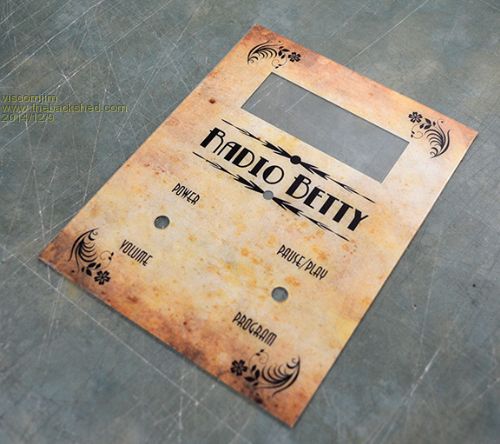

I reverse printed a "decal" for the front panel and applied it to the back side of some thin non-glare acrylic with the cutouts for the display and the IR detector. I tried to hide the detector in the graphics.

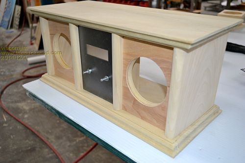

I put my close to non existent woodworking skills into play to make this simple cabinet.
A little stain and clearcoat.

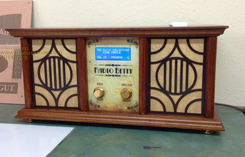

I used some gold material and laser cut some plastic for the speaker grills. Found some nice gold guitar knobs and gold feet. Notice the apple remote sitting on top.
This better get me some brownie points with my mother in law and hopefully her beautiful daughter will understand what in the world i am doing in my "lab" all the time.
I downloaded about 250 old time radio programs, including the hindenburg disaster, war of the worlds, abbot and costello, amos and andy, etc. along with 32 full Elvis Presley CDs onto the sd card. The encoders control the program selection, volume, pause and play. The lcd displays the program number, the volume and 2 lines of information about what is playing. When the unit is "off" it displays "RADIO BETTY", the time and date and temperature.
