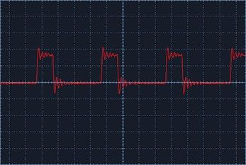

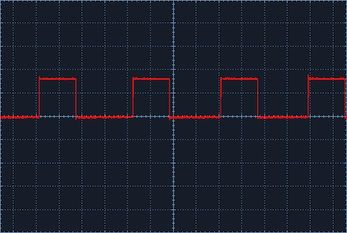

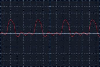

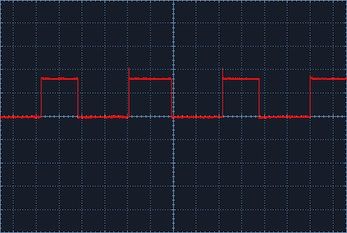

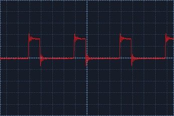

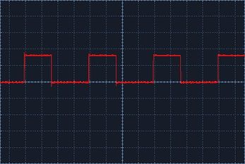

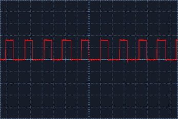

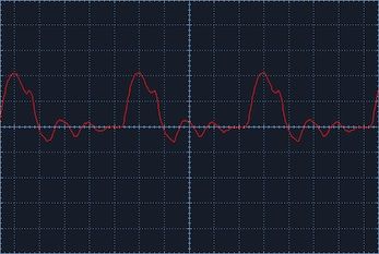

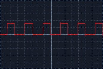

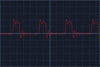

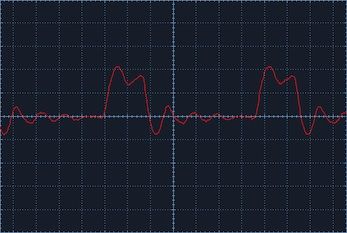

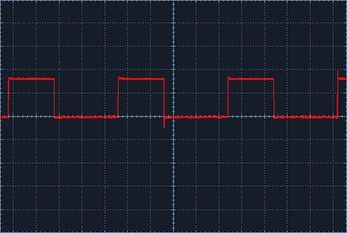

Test results.
Basic samples first. Used a simple loop with pin on and off.
CPU=5mhz IO speed=1.2khz pulse=808us
CPU=10mhz IO speed=2.5khz pulse=392us
CPU=20mhz IO speed=5.2khz pulse=192us
CPU=30mhz IO speed=7.8khz pulse=128us
CPU=40mhz IO speed=10.4khz pulse=96us
CPU=48mhz IO speed=12.5khz pulse=80us
cwilt
Joined: 20/03/2012
Posts: 147
Posted: 04:59pm 08 Dec 2014
Cfunction using Peters pulsetrain. Thanks again for the code.
CPU=5mhz IO speed=1.25mhz Pulse=0.797us
CPU=10mhz IO speed=2.5mhz Pulse=0.399us
CPU=20mhz IO speed=5.0mhz Pulse=0.199us
CPU=30mhz IO speed=7.5mhz Pulse=0.133us
CPU=40mhz IO speed=10.0mhz Pulse=0.100us
CPU=48mhz IO speed=12.0mhz Pulse=0.083us
cwilt
Joined: 20/03/2012
Posts: 147
Posted: 05:00pm 08 Dec 2014
These images are 1/2 scale. I will upload full size if asked.
