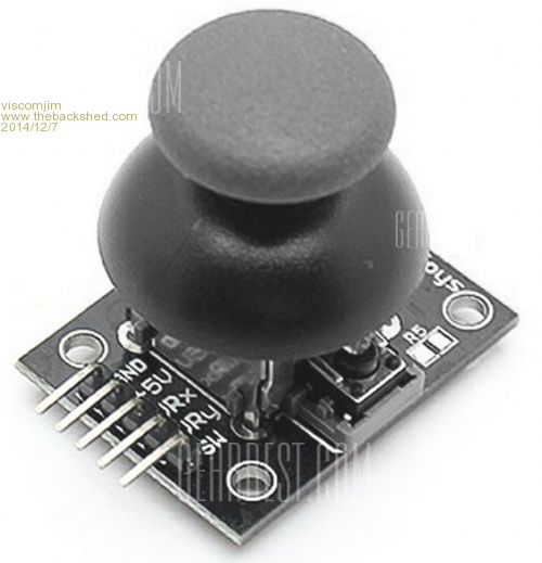

For the 5 switches that are used for up down previous next and enter, I will be implementing one of these.
I hooked one up to uMite using 2 analog inputs and one digital (can be interrupt too), and just by checking range using > or <, you can easily use it as 4 switches, or even 8 if you read both x and y for the corners and use the push switch for enter. These are quite inexpensive and look really cool too. Obviously they can also be used as analog joysticks also... but for this project it will just be 5 position switch using 3 inputs.Edited by viscomjim 2014-12-08

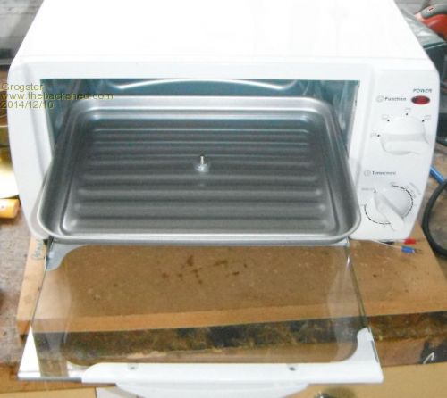

While we still have a semi-active reflow oven thread, here is my one:
The thermocouple is bolted to the middle of the toaster oven tray.
As these cheap toaster ovens have no thermal insulation like a proper house kitchen oven, it was a simple matter to drill a hole in the back of the oven to pass the thermocouple cable out of.
I picked up the toaster oven for $15 new at a warehouse sale.

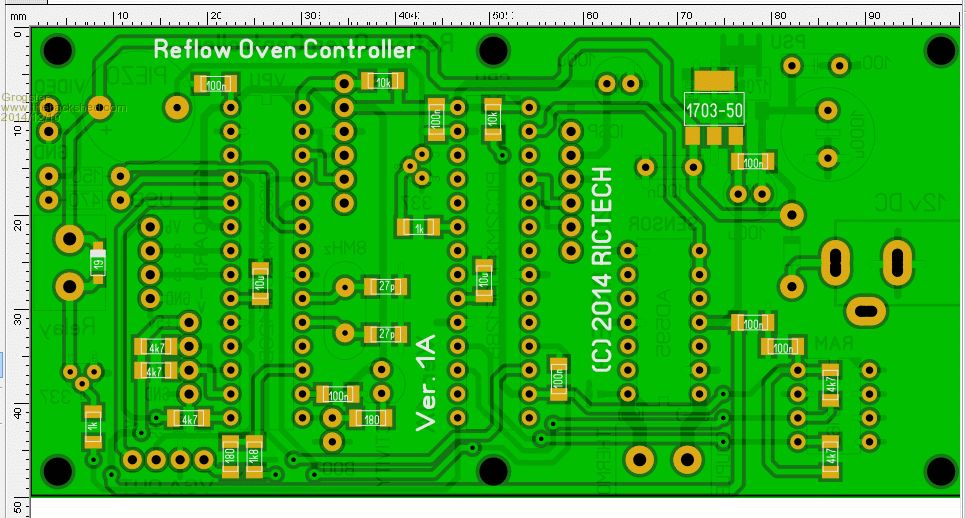

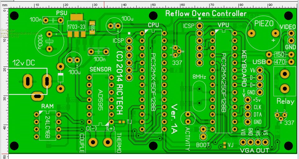

The controller PCB - top:
...and bottom:
This controller has the 595 thermocouple amp, a Micromite CPU and a VT100 all on the one board. With the VT100's nice big font options, the plan is to couple this up to one of those dinky wee composite video displays that can be had on eBay for $50 or less. I could have used an LCD, but am so in love with the VT100.........
